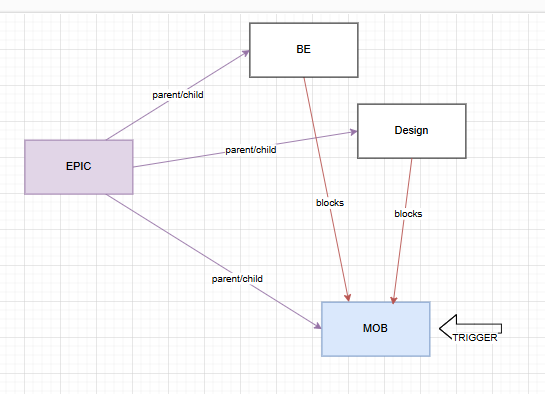

The initial design was to have a manual rule that would create several tasks from an epic and then link them together. This worked well as a single-threaded automation, using a variable to store the previously created KEY_ID and then utilizing that {{key_id}} in the linked issue block.

Finally, I decided to create two separate automations:
- One to create a group of tasks.

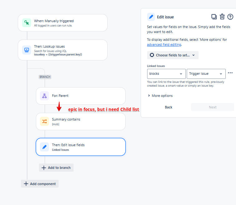

- Another to link them together using the logic shown in the image below.
And now I'm stuck even on this seemingly simple automation!
If I set the trigger issue as the Epic itself and then use the 'for children relation' branch, I'm unable to utilize IF-ELSE conditions to process each task one by one, check its presence, and then create a link.
If I set the trigger issue as one of the child tasks, it seems I can't retrieve a list of its siblings. Moreover, if I use the 'for parent' branch to go one level up, I can't then target the siblings.
I've tried using JQL filtering, such as:
summary ~ "[BE]" AND parent = "{{triggerIssue.key}}" (or triggerIssue.parent.key for case then i attempted to use a simple task as trigger)
In the preview, this returns '1' result, but when I run the rule, it always finds nothing. Is this a bug?
