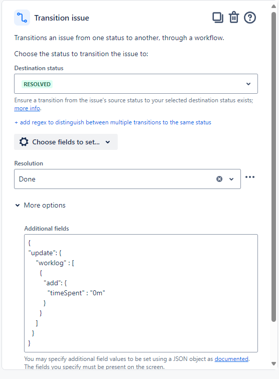

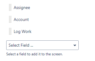

I have an Automation rule that transitions an issue and logs work during that transition. That is required because of a transition screen that has "Log work" as a mandatory field (Validator).
The rule worked fine until a couple of days ago. We installed Time Tracker & Gadgets (Tempo) a week ago, so might have something to do with it, but the time tracking still is set to the Jira Standard.
The rule:
The transition screen:
The rule fails with the error message below (and ultimately because the field isn't set and the Validator fails):
Unknown fields set during transition. Field may not be on transition screen. Fields ignored -
Log Work (worklog)
