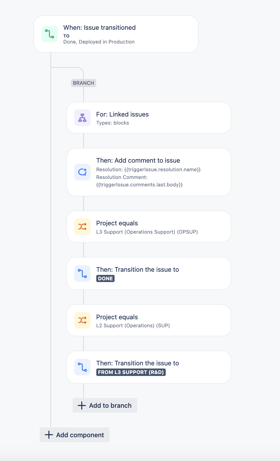

Hello! I have 3 projects L2 support -> L3 Support -> Dev Sprint. I have automations to create issues on L3 Support and Dev Sprint based on L2 support and links the created issue as "blocks" the parent.
Now I want to propagate the resolution from Dev to the other projects. So I created a multi project rule that is triggered on issue transition on the 3 projects.
I built this rule

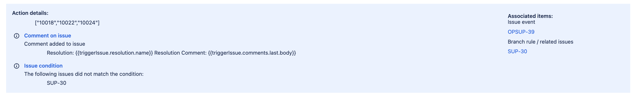

This rule works ok and transitions the L3 Support to DONE (first IF), but when it runs for the 2nd transition (SUP) looks like the branch ends on the first if, and the second if never runs.
What I'm doing wrong?
