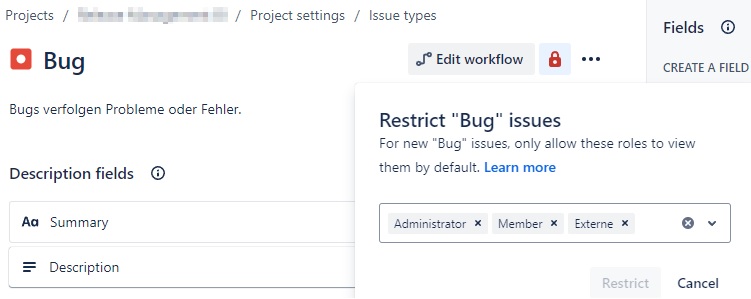

We have created a custom role ("Fachbereich") for a group of users which shouldn't see specific issue types (bugs). It should be possible to de-restrict non-sensitive bugs to this group or if their collaboration is needed.
To achieve this, we've restricted the visibility of this specific and other issue types to the other roles ("Fachbereich" excluded) by default:

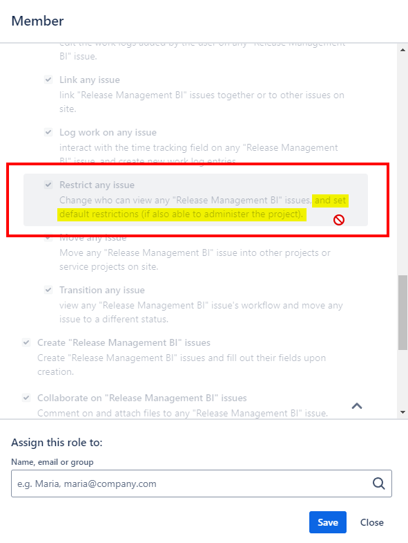

Afaik, the possibility to restrict a issue or remove an existing restriction for an issue is linked to the permission "restrict any issue" which is by default granted to the roles "Member" and "Administrator":

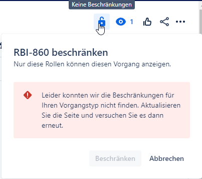

Users with the role "Member" should therefore be able to restrict and change the restriction of a issue (because some issues contain sensitive information, some issues don't) when creating/viewing one. This can be done via the lock-symbol while viewing a issue.
However, they (Members, default role) only get the following error when clicking the lock-symbol when viewing an issue: Translation: "We couldn’t find your issue type’s restrictions. Refresh the page and try again." It doesn't matter if it's an old issue created before the default restriction was implemented (so there's no active restriction for the issue), new issues with the default restriction or an issue of a type for which no default restriction is defined.
However, Administrators (default role) are able to change the restriction of old existing (created before the default restriction was implemented) and existing (created after the default restriction was implemented) issues without a problem.

However, the permission to administer the project should only be needed for changing the default restriction, at least that's what I understood from the description:
It would not make much sense to mention the role Member in the article linked/posted above, if they're not able to use this function anyway:
