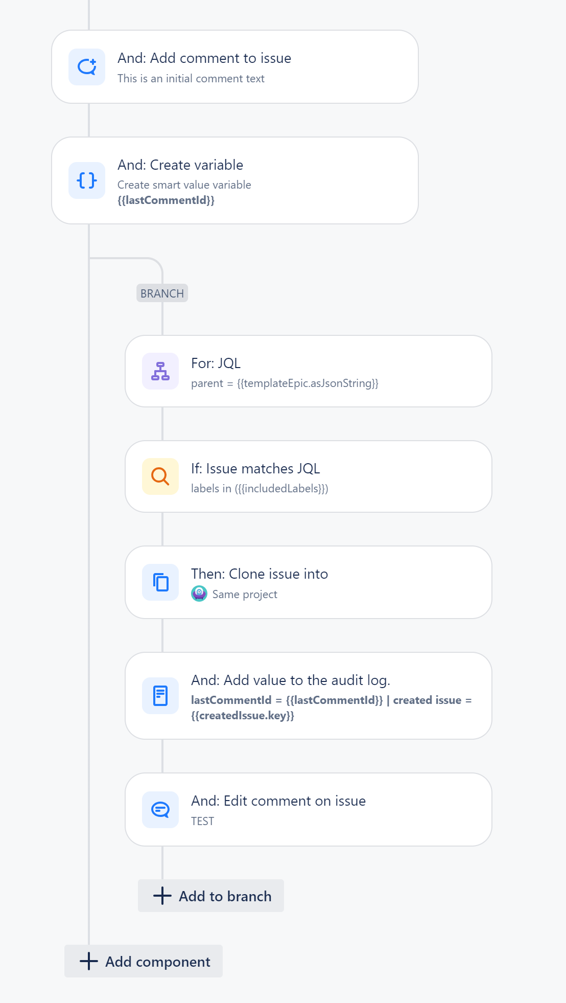

Here is that part of my automation:

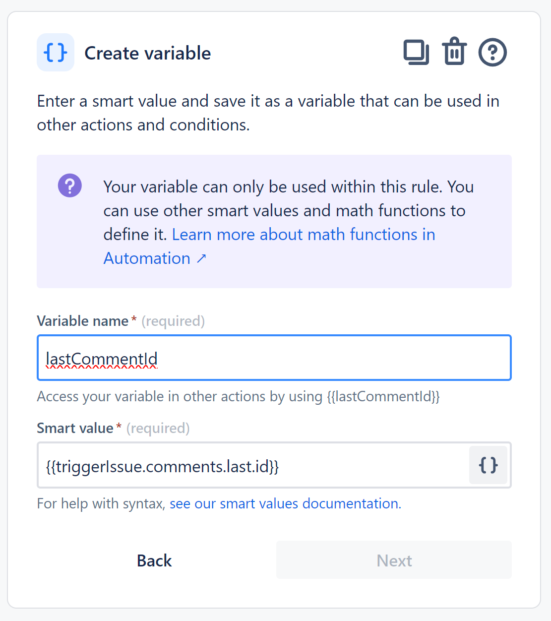

Here are the parameters of certain actions from the automation above:

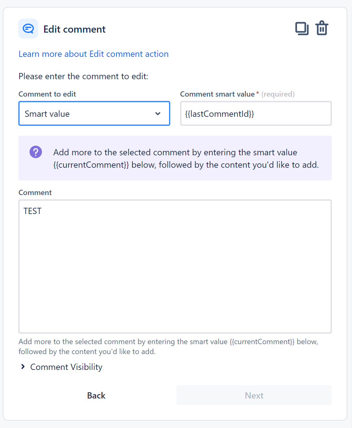

This is an example of an Edit Comment action with just a simple text "TEST" to illustrate that even that one is leading to this "No comment to edit" error:

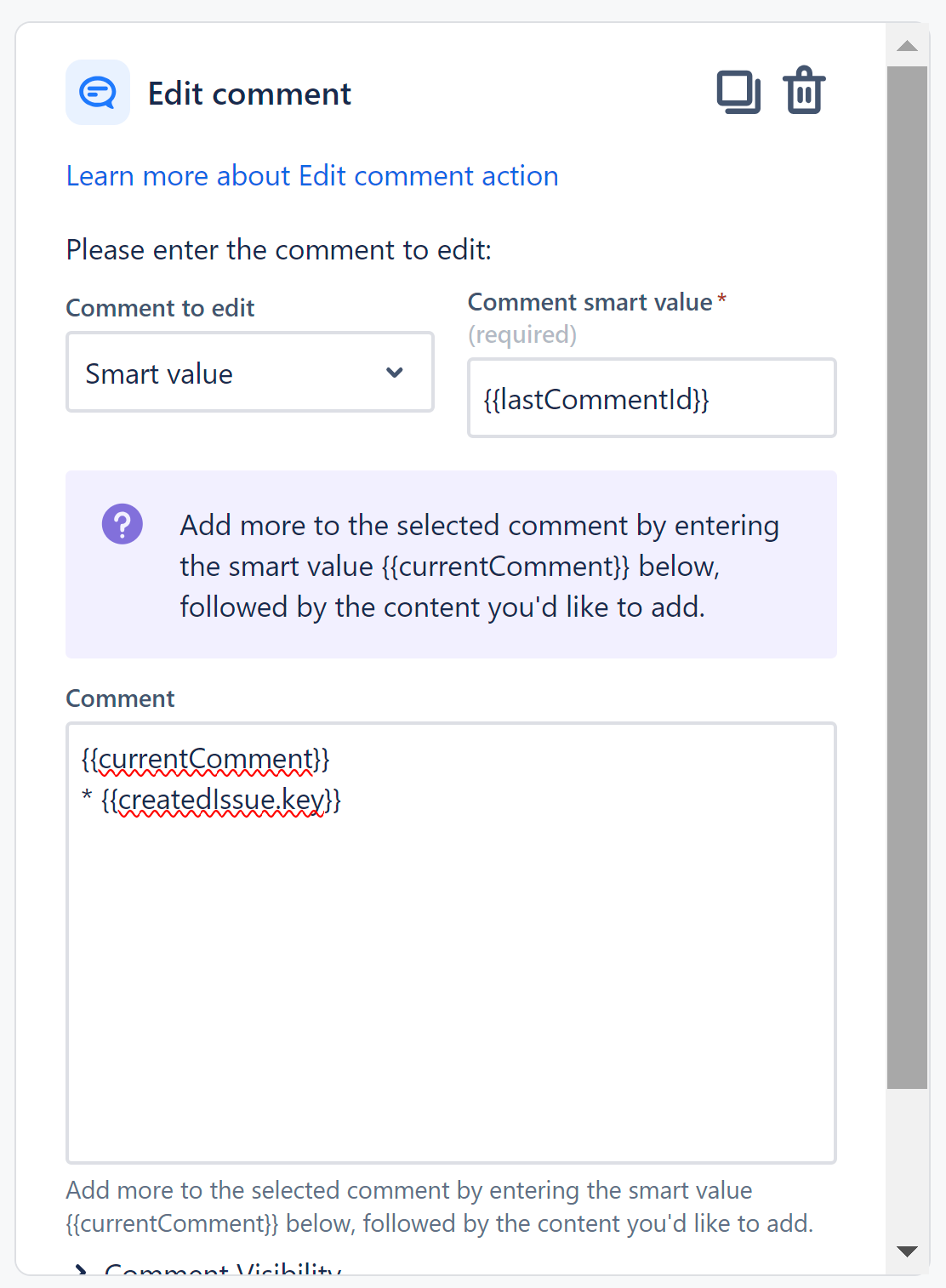

This is an original Edit Comment action, where I was expecting the initial comment to be updated with the list of the keys of the cloned issues:

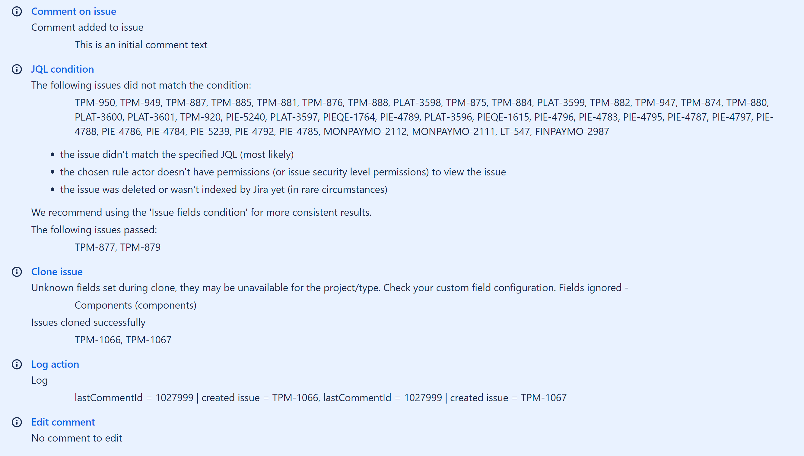

And here is what I see in the logs after running the automation (comment ID logged here is a valid one and it corresponds to that initial comment, which was added prior to entering the branch) :
