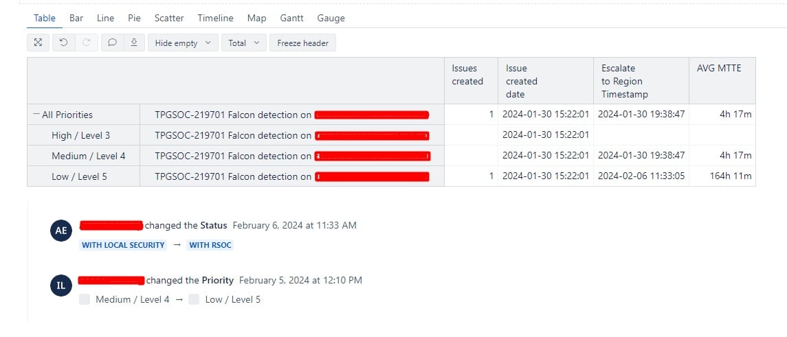

The problem i am dealing with is that there is some kind of reset to the Escalate to Region Timestamp measure when we change the ticket priority.
In the example below, the ticket was high priority when it was created and immediately changed to Medium. Then we transitioned the ticket to status With RSOC and we get AVG MTTE 4h17m.
After that the priority was changed to Low and then it was transitioned to status With RSOC again and the problem appears. We have another entry for AVG MTTE because as it looks like there is a new Escalate to Region Timestamp which is the same time with the time the ticket was transitioned to status With RSOC after the priority change.
So at my final report of AVG MTTE for all issues filtered by priority, the ticket above is calculated twice and we don't want that. We want to calculate only the actual first time the ticket was transitioned to status With RSOC when it had Medium priority.
Is there a way we can achieve that?
