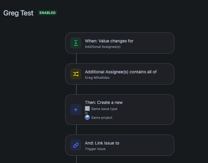

Looking for help with an automation we are trying to run. Details are below.
Summary: We have multiple projects running and the purpose of the automation is to connect them when work required is cross-functional by avoiding manual creation of new issues in other projects.

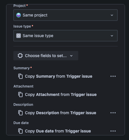

The goal: When we add a specific stakeholder in the 'additional assignee(s)' field in the origin epic, it should create a new epic in a different project with all of the same information pulling through since the fields all match and then the two epics should be linked together.

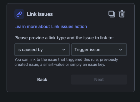

The Issue: the rule shows as successful when the identified stakeholder is added to the additional assignee(s) field and the new epic in the other project is successfully created, but the two are not linked together. It appears the hold up is in the "And: Link to" section of the automation. It is set to: 'is caused by' 'trigger issue'. We've tested using the other option: 'most recently created issue' and that works just fine but would open up room for error within our processes. It needs to be trigger issue to work properly. When the rule is run, the new epic is created perfectly but there is no link between them.
Any thoughts or guidance would be much appreciated, thank you!
Note: the screenshots provided show the test is using my name for each of the tasks since I wanted to limit the number of notifications team members were getting. I did test this with other team members within the other project and can confirm the issue isn't that I'm using myself or staying within the original project for each of the actions/assignments.
Screenshots added below, more can be provided.
