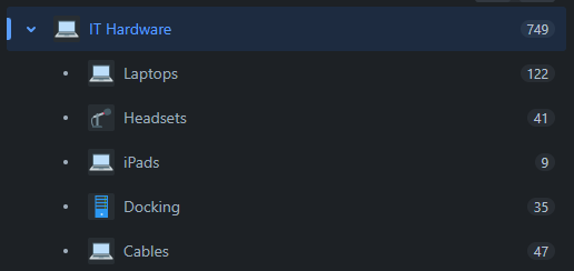

We are looking at two object schemas - one for people/users with 1 object type "People", and one for IT assets containing multiple object types (e.g., "Laptops", "Mobile phones"...)

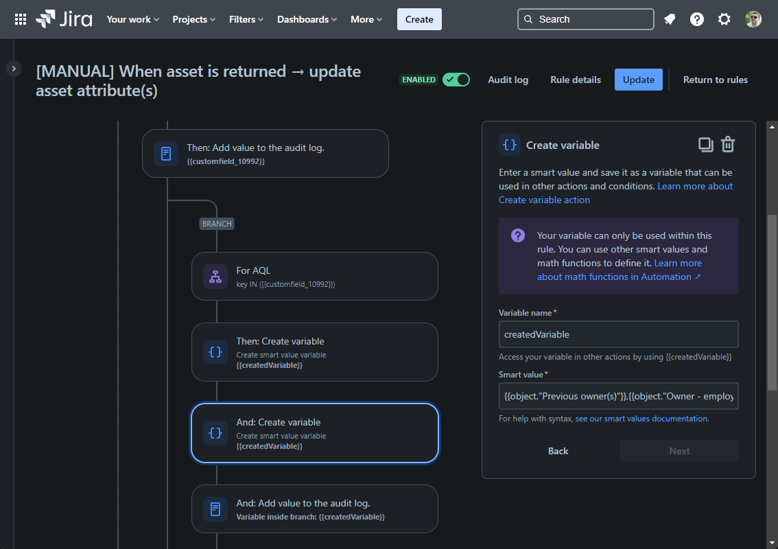

Imagine that the JSM ticket has 2 objects (let's call them Object 1 and Object 2) linked and I'm owner of both of these objects. Both of these objects had previous owners where "Object 1" had Person A as a previous owner and Object 2 had Person B as previous owner.
Now, the automation should do the following - once ticket reaches specific status, remove current owners from both objects (this part works okay), and change the value of Previous owner(s) attribute by only adding "current" owner to the list. So, after the automation is done, we should have something like this:
- Object 1 ("Previous owner(s)"): Person A, Tomislav Tobijas
- Object 2 ("Previous owner(s)"): Person B, Tomislav Tobijas
Automation is using the following solution for appending the values to object attribute: https://confluence.atlassian.com/jirakb/how-to-append-objects-to-an-assets-object-attribute-using-automation-1283493731.html

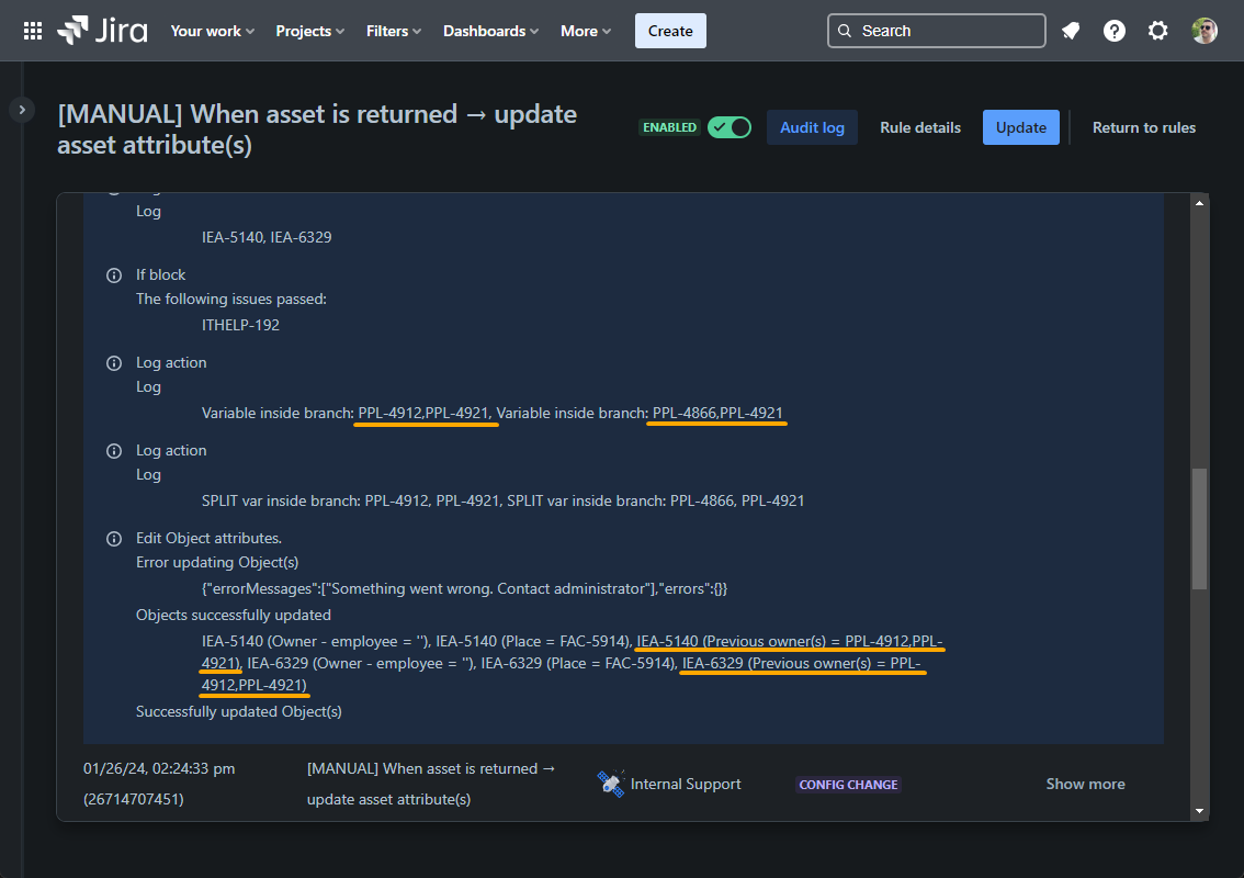

Now, according to rule logs, created variable is correct upon creating but once it is used in Edit Assets field attribute action, it updates both objects with 'same' values and I end up with the following result:
- Object 2 ("Previous owner(s)"): Person A, Tomislav Tobijas (❌ not ok)
I'm wondering if I'm missing something here? Does the automation and (AQL) branching work in a way that if there are multiple objects inside branch:
- Iteration 1: For object 1 > create variable
- Iteration 1: For object 1 > update attributes
- Iteration 2: For object 2 > create variable
- Iteration 2: For object 2 > update attributes
Or does it work in some other mysterious ways? 😅
