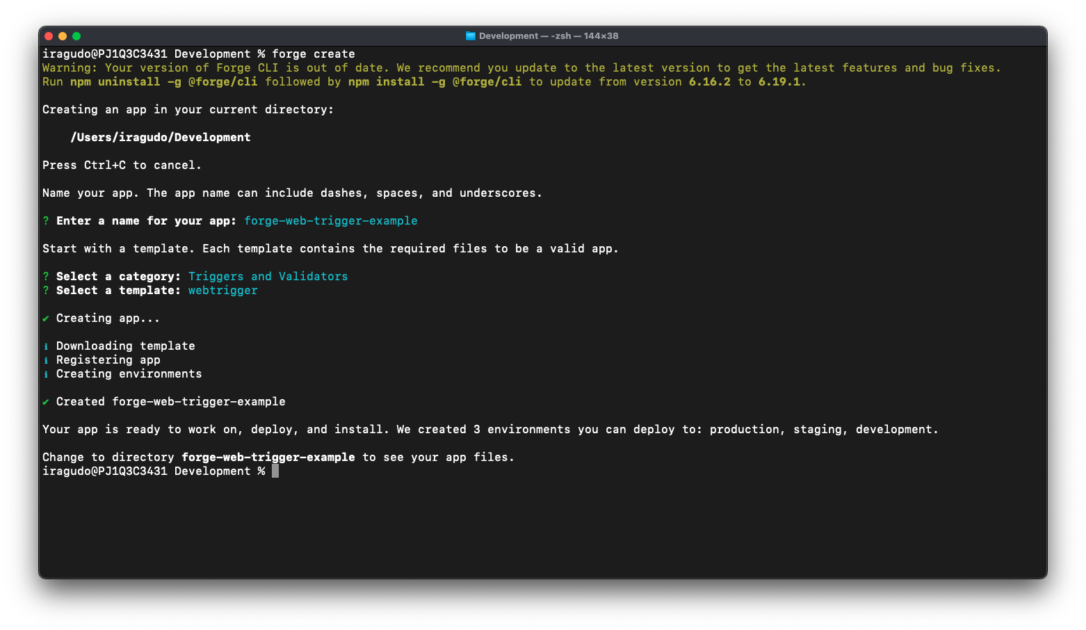

Step 1: Create a Forge app using the webtrigger template
Open your CLI and call forge create
Name your app e.g., forge-web-trigger-example
Select the category Triggers and Validators
Select webtrigger as the template
