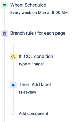

Automation 1: Add automation to automatically add label "ts-review" to content that hasn't been updated within the last 6 months.
*This is working as intended.

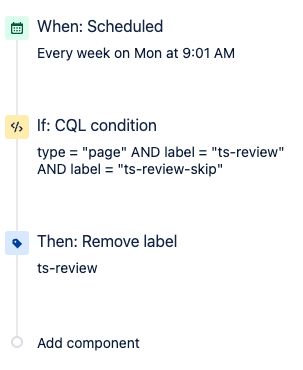

Automation 2: Add automation for content we don't want to be flagged for review, remove tag "ts-review" on any article with the tag "ts-review-skip."
*This part returns the following error in the audit log: No CQL-compatible content found in the rule context; there is nothing to check against the CQL query. The CQL condition component can only follow components that involve CQL-compatible content, such as the blogpost published trigger, the publish new page action, or the related entities branch.

- Why am I receiving an error in my audit log for the second automation?
- If there isn't a way to remove a label with automation, would there be a way to set up alternative automation to achieve the same behavior? Not ideal, but for example, could we set up an automation to automatically re-publish content with a skip label so it gets excluded from the audit?
