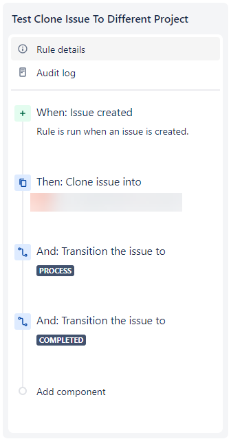

Below are screenshots of the automation I have created:
This is the automation in project A that is cloning the initial issue. This works.

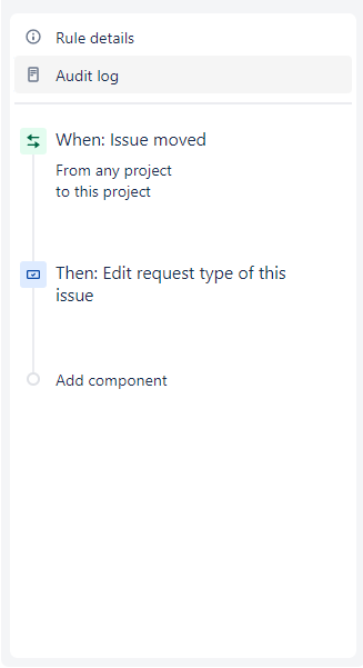

This is the automation in project B that is attempting to set the request type of the cloned issue. This is not triggering.
