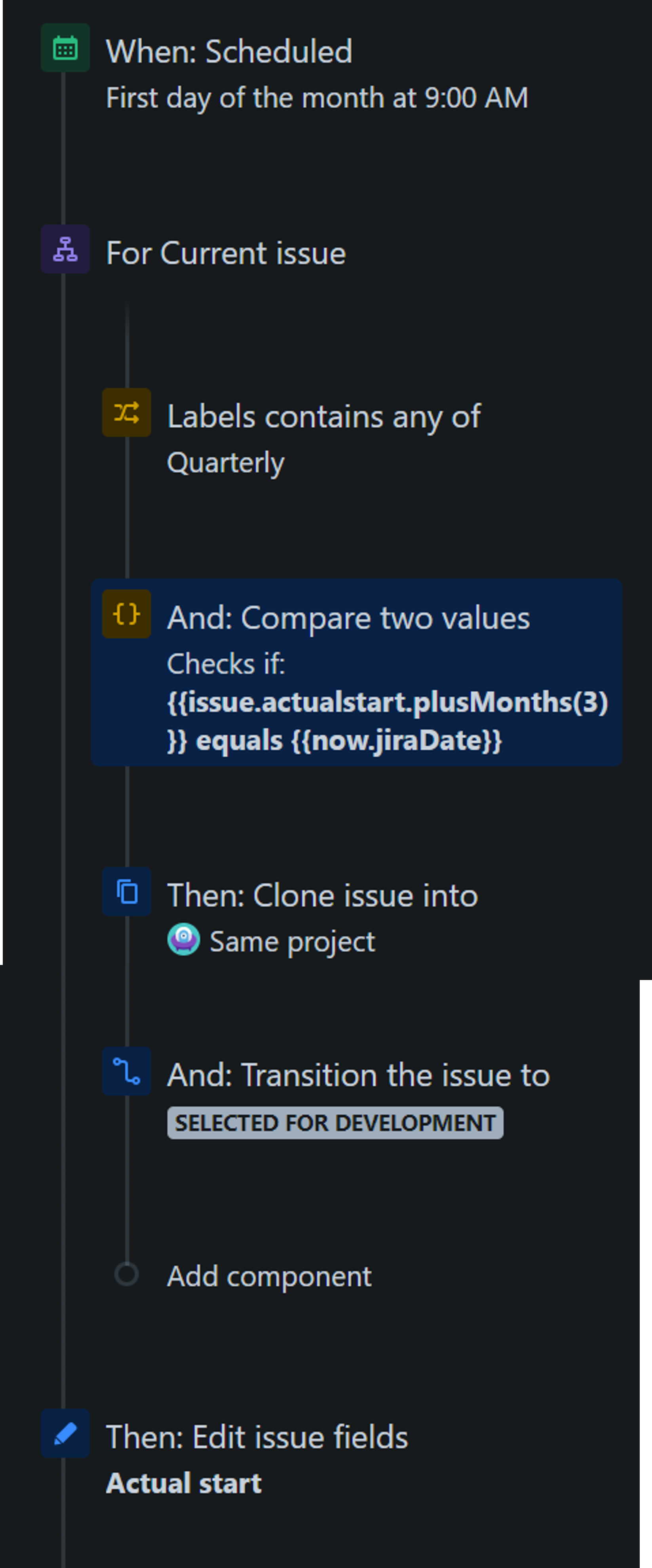

For Quarterly, I tried an Advance Compare Condition, but the automation did not consider the comparison of the task's {{issue.actualstart.plusMonths(3)}} - equal to the value {{now.jiraDate}} when I had set the task's "Actual Start" value to November 1, hoping the automation would trigger today, February 1.
The same automation rule failed for Bi-Yearly and Yearly when "Actual Start" was set to 6 months and one year prior, respectively.
I've attached the branch for Quarterly, hoping that if I can get a solution for that, I'll be able to modify the solution to work for the other Label values and Date Comparisons.
