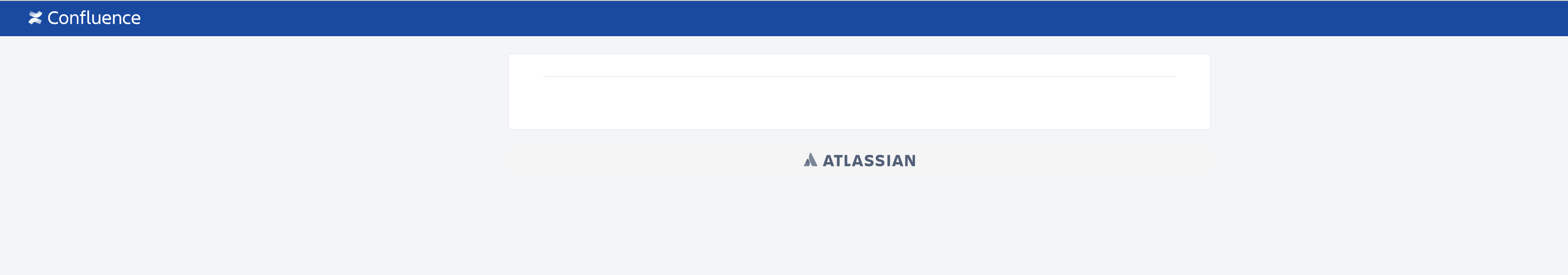

Im trying to install an atlassian suite on Kubernetes. But having some problems with Confluence. I have just setup the pv and pvc and tried to install the confluence helm chart again, the confluence pod is running.
When I try to access confluence it is stuck on a setup page (see attached image)
setup/dosetupstart.action?setupType=custom&atl_token=
Logs from the pod are also attached below.
Can anyone point me to a cause of this?
