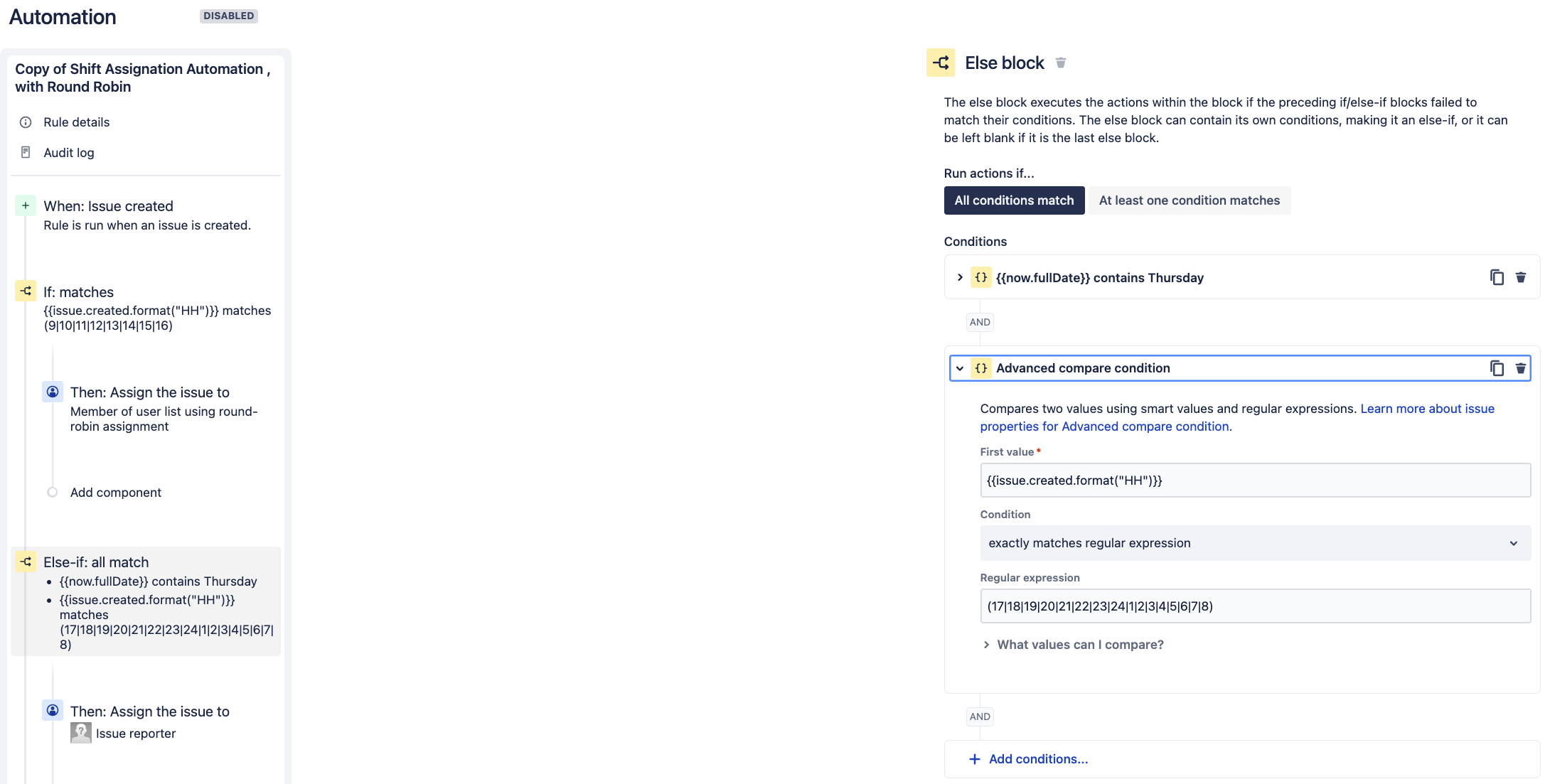

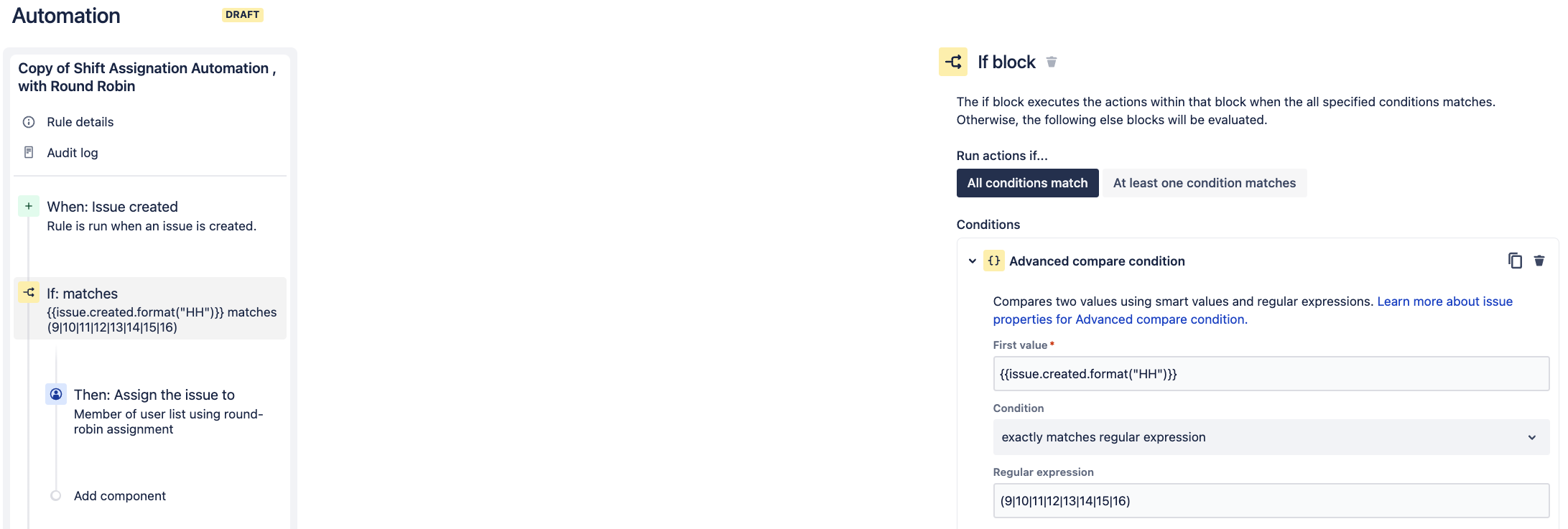

The basic syntax is the following:
The above format gets repeated for every hour of the day you need to assign. An example would be from 10:00 to 10:59 in a 24Hr format.
For example if your shift is 8 hours, we would have to repeat the above syntax 8 times and a 9th one for a catch all.
The last run is so that you can let your customers know that their ticket was received out of working hours so this one is optional
An example of this Automation can be found below:
All other hours in your shift should be covered by ELSE Commands as bellow:
NOTE: In the example above you will see a couple of hours being covered, this is useful when using this Automation to cover a whole shift.
