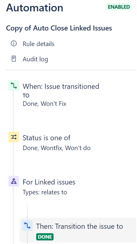

I've been researching the way to achieve this, and through documentation and forums I've crafted this:
What I'm stuck with at the moment is that this simply isn't working. I've tried using the automation on A but not B, B but not A, and on both and no matter what, transitioning the issue in B to one of the specified statuses does not close the issue in A. From what I can tell, this automation configuration has worked for others, and clearly I'm missing something escapes me at the moment. Does anyone have any tips or advice?

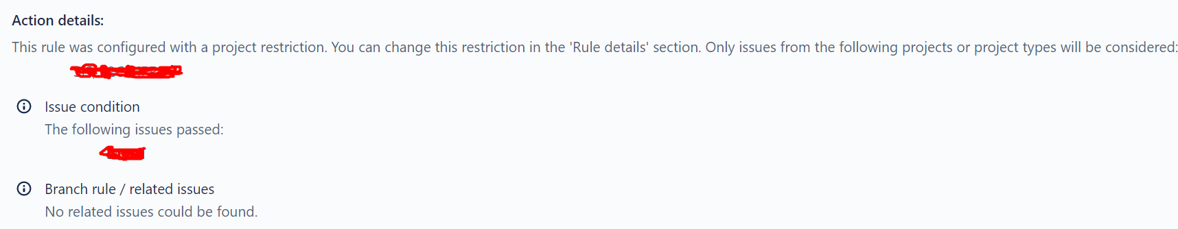

The audit log shows this:
Crossed out are the keys of the two projects and the issue name.
I have verified that issues in B that are Done, Wontfix, or Won't do still have the linked ticket from A...and in A that ticket still has the status TO DO.
I can also see that on ticket A, the correct status for the linked issue in B is showing.
