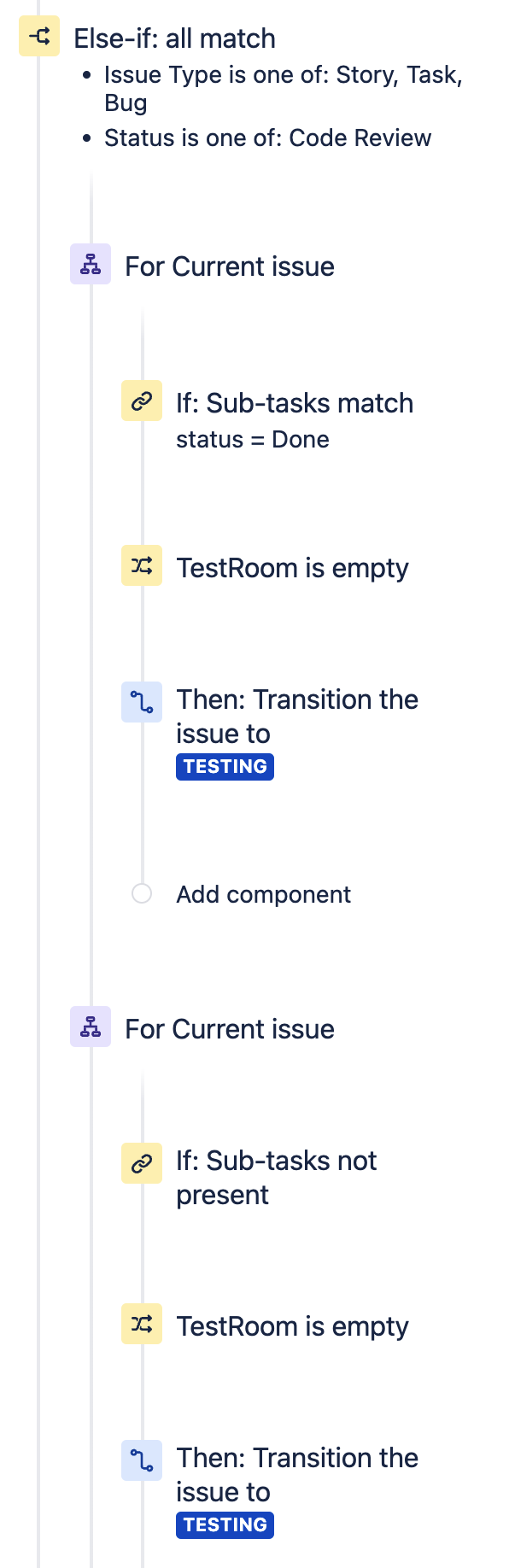

So I have a trigger when the PR is merged!Ā
Then I check the type of ticket and current status to see if I can transition it (we have a guided workflow).
Ā
When I enter the Else-ifĀ part, and if the issue has no subtasks, the condition fails and then doesn't make the transition. And as we can't set an if-else inside an other if-else, then I would like to know the solution to have in the For Current IssueĀ the possibility to check if NO subtasks or ALL DONE
Ā
For now I have these 2 separated blocks of FOR CURRENT ISSUEĀ that I would like to merge in 1.Ā
Ā
Thank you
