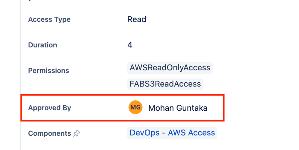

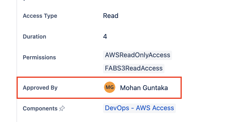

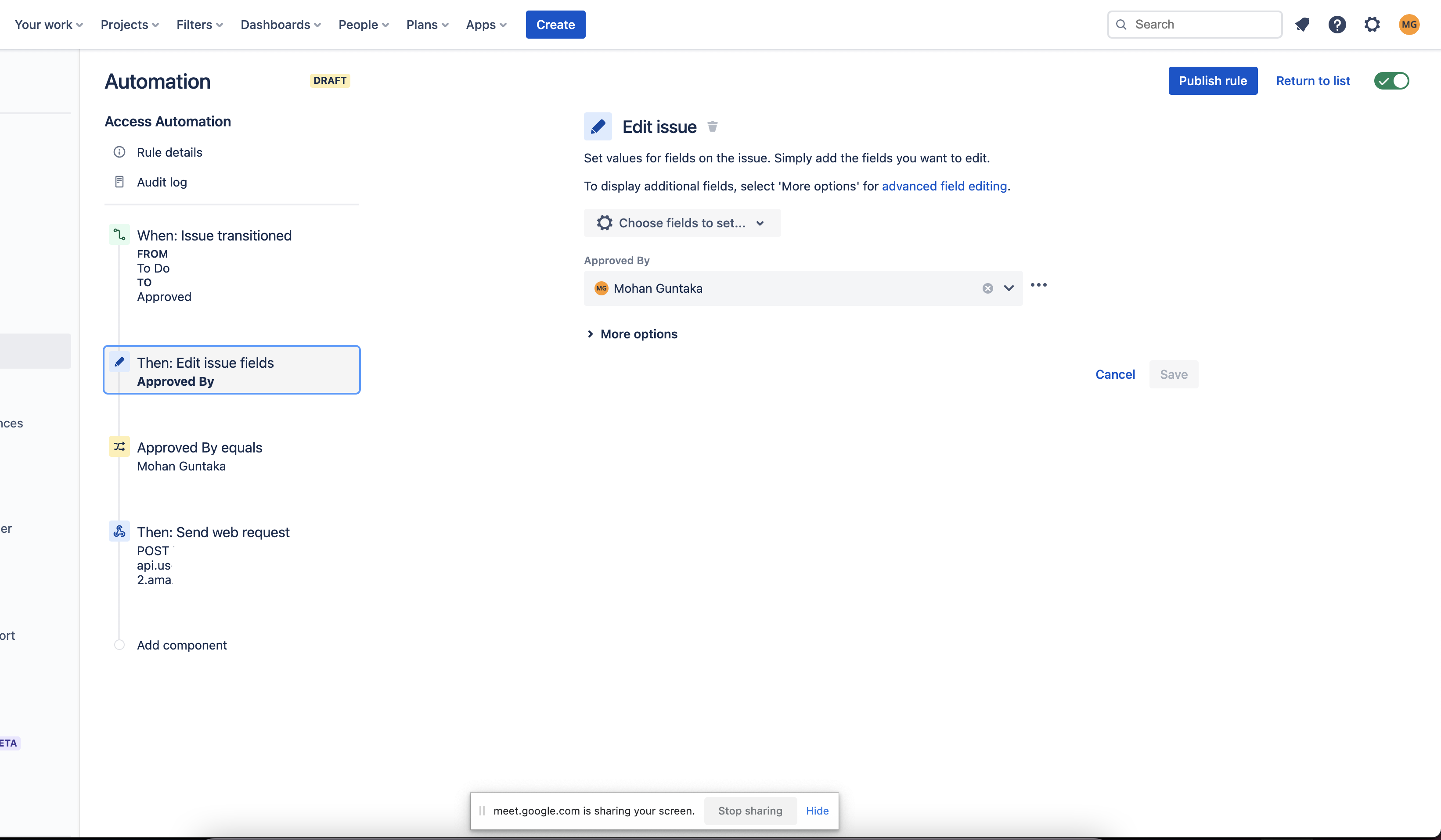

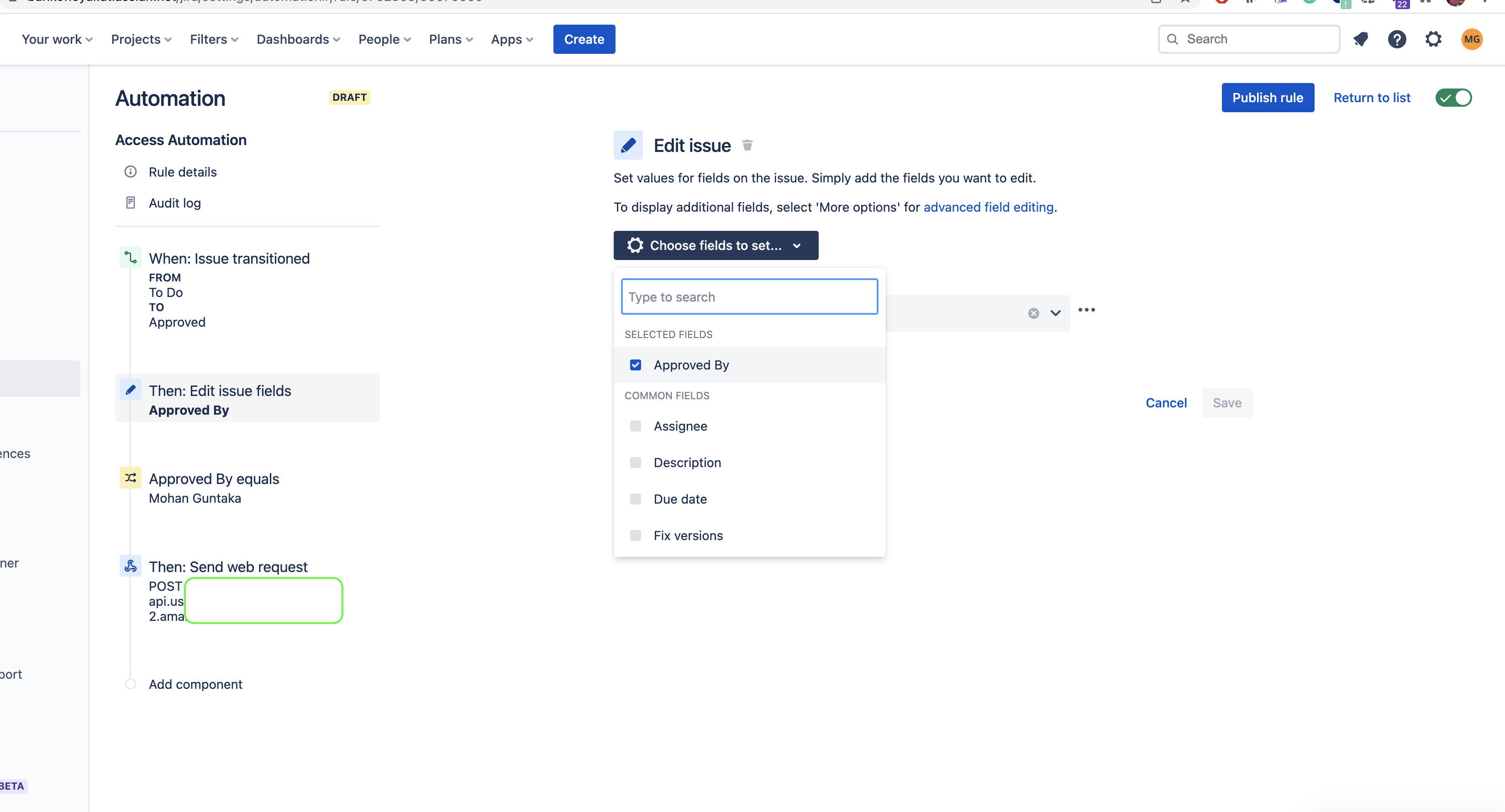

Created a new component that populated one of the user type custom field (Approved by) and then invokes api. Question 1 - What this field has to be mapped to? Ideally, this value has to be the user who triggered the event, but this is not available in the drop-down. For testing purpose, we populated a static value (User) and tested the use case. We are receiving value as null, in the request body for this custom field but the same static value is shown on UI, please refer to below screenshots (approved_by_component.png, approved_by_component-2.png, approved-by-component-on-ui.png ).

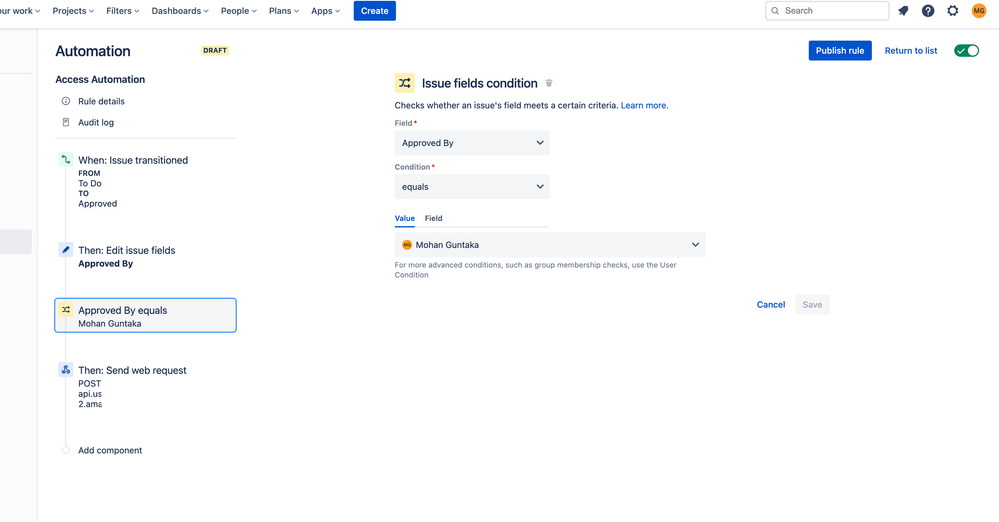

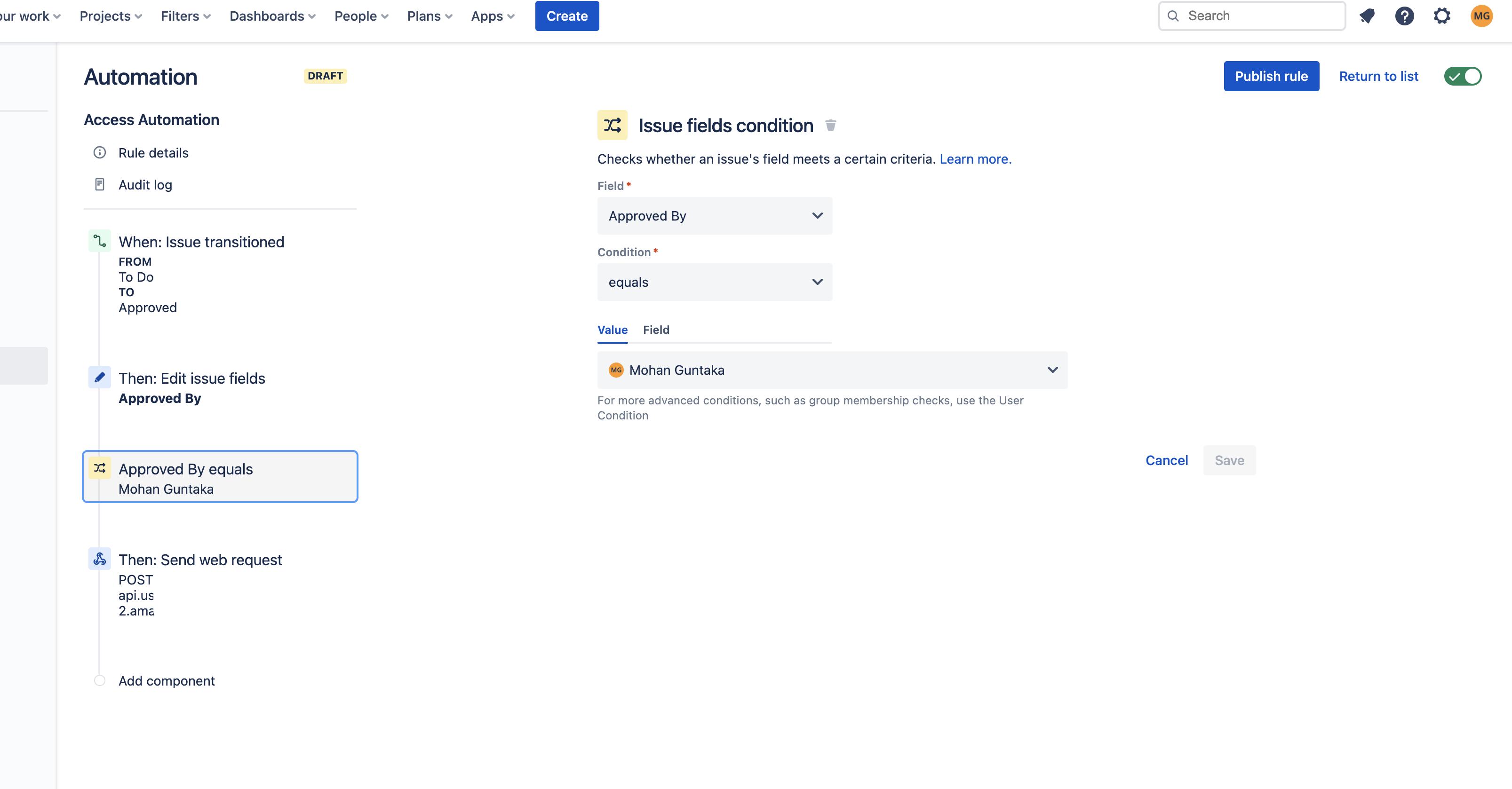

To verify if the custom field is populated or not before invoking API, we created an if condition, as Approved by equals to the user (same user set in above components) and tested the workflow it gave error Condition, doesn’t meet the requirements, which means the value is not set in the component and state flow directly jumps to if condition. please refer screenshot (if-condition.png )
