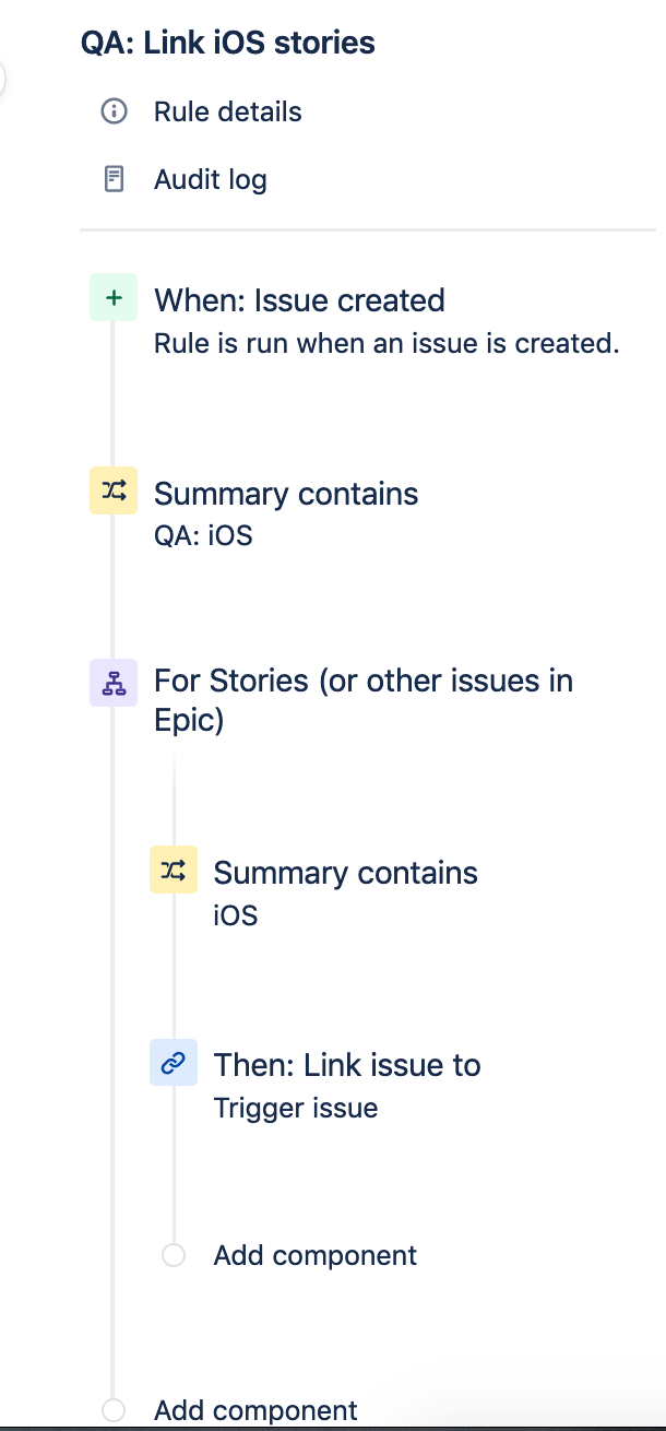

What I've tried so far:
- Branch > "For Stories (or other issues in epic)" - this seems to be what I want, but I can't get this to work at all.
- When I use the above, then create a task called "QA: iOS", nothing happens - it does not link to the other stories in the epic with "iOS" in the summary.
- Simply using the "Then: Link issue to" is much more straightforward; however, I don't know which issue to link it to. I'm not sure "Trigger issue" would make sense (wouldn't that link to itself?); I can enter in a specific issue key and that works, but I can't use that as I want this rule to apply to all epics going forward (but only run within one epic at a time). Is there a way to use JQL or other smart search to say, "find any issues in the same epic as the trigger issue, with 'iOS' in the summary"?

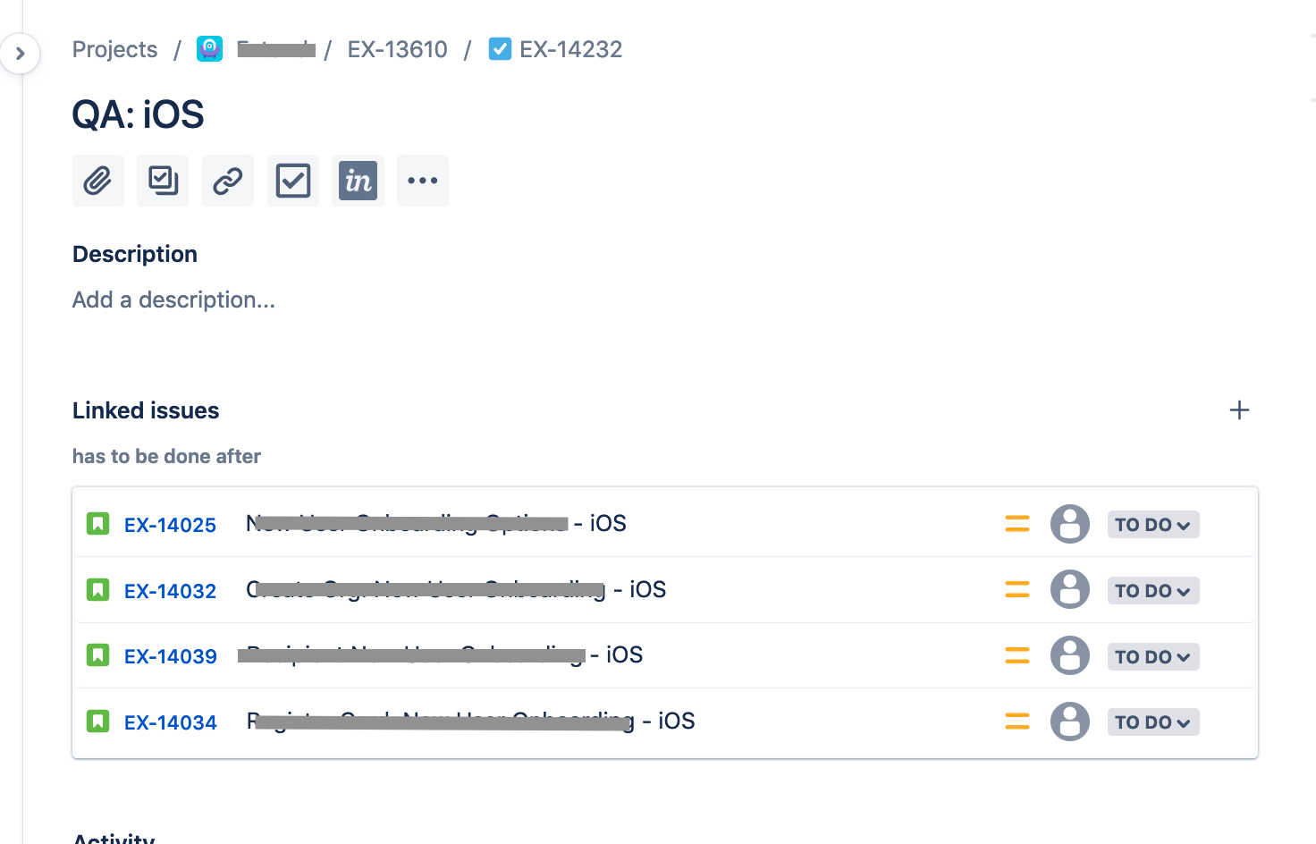

I would like it to look like this in the end, when creating either the "QA" task or any of the "iOS" stories:
I will be doing the same for other platforms, so it will always be "QA" in the task and then either "iOS," "Android", or "Web" to find the corresponding stories.
