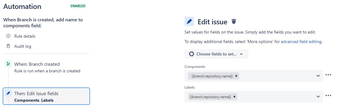

We are currently having trouble with the first step in this process and hoping someone could help us. We currently have the following automation rules set up:
When a branch is opened, the repository name should be added to the components field and the labels field (with the labels field acting more as a check to see if its working since it doesnt rely on pre-filled choices like the components field.)
We then added all of our repository names to the list of components and tried running the automation. Unfortunately, we are having some weird mixed success where repository names are working and some are not.
For Example, api-usage, one of our repository names works correctly and writes to the component field when the branch is created:
![2022-01-13 15_58_47-[AT-3765] Test Jira Automation with Craig - Jira.jpg 2022-01-13 15_58_47-[AT-3765] Test Jira Automation with Craig - Jira.jpg](https://us.v-cdn.net/6038660/uploads/images/177698i488BD427E713AD99/2022-01-13%2015_58_47-%5BAT-3765%5D%20Test%20Jira%20Automation%20with%20Craig%20-%20Jira.jpg)
However, p44, another repository does not work, despite being included in the components list and the label field updating correctly:![2022-01-13 16_03_01-[AT-3765] Test Jira Automation with Craig - Jira.png 2022-01-13 16_03_01-[AT-3765] Test Jira Automation with Craig - Jira.png](https://us.v-cdn.net/6038660/uploads/images/177699i2AC081752E906E64/2022-01-13%2016_03_01-%5BAT-3765%5D%20Test%20Jira%20Automation%20with%20Craig%20-%20Jira.png)
![2022-01-13 16_01_55-[AT-3765] Test Jira Automation with Craig - Jira.png 2022-01-13 16_01_55-[AT-3765] Test Jira Automation with Craig - Jira.png](https://us.v-cdn.net/6038660/uploads/images/177700i16B83C355367CDD4/2022-01-13%2016_01_55-%5BAT-3765%5D%20Test%20Jira%20Automation%20with%20Craig%20-%20Jira.png)
Would anyone be able to help figure out what we may be doing wrong?
