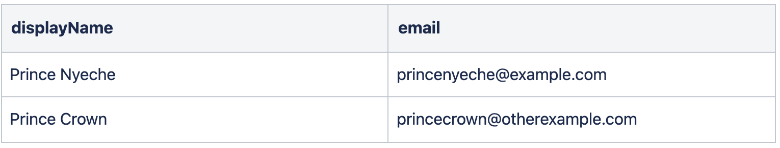

If you’re moving from server or datacenter or even from another cloud instance to Atlassian cloud, you can start first by exporting all your customer users. In our scenario above, the project owner has 25K customer users which need to be migrated. The project owner can export the customer users from their source instances in the below CSV format and use the BulkOps app for Jira to create all those customer users. The exported users need to be formatted into a CSV file with the below formatting.
With the above data, you can use the “bulk create users” features of the BulkOps app for Jira to create your entire 25K customer users into your cloud instance.

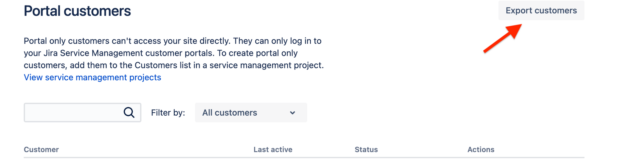

Go to your cloud instance after the customer users have been created by navigating to https://your-instance.atlassian.net/admin/jira-service-desk/portal-only-customers and perform an export of all your users to get their accountId. Delete all other columns, except the “username” and “fullname” columns then save the file

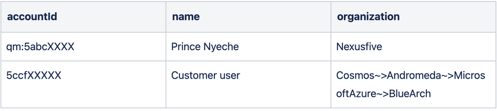

With the organizations created, you can create a new file with the list of customers you want to present on those organizations or projects. Use the below format for the CSV file to structure your data.
Simply upload the above file with its data content to have the users added to the specific organizations. Please note that organizations are case sensitive, so ensure that you’re using the right name at all times. Use the “bulk add customers” feature. Prior to submission ensure you set the “Customer selection” to “JSM Organization” while using the app.

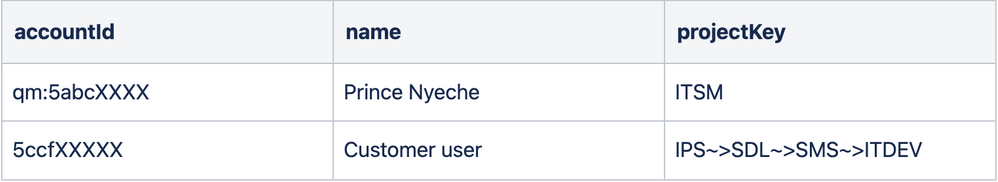

Perform a similar file structure if you want the customers to be added to projects as shown below.
Once your file above is prepared, simply upload the file and set the option for customer selection to “JSM Project” prior to submission. Use this delimiter ~> for adding customers to multiple projects or organizations at the same time.

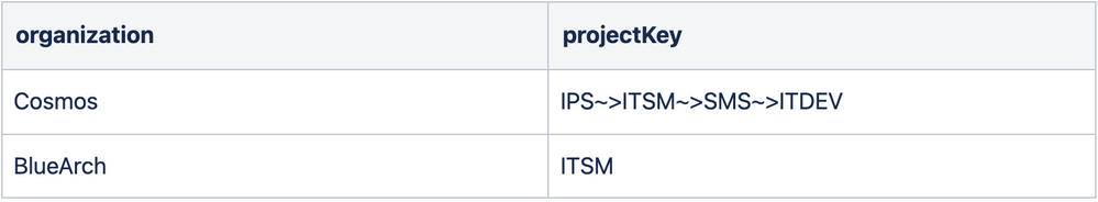

The last step is to include the said organization into the specific Jira Service Management project. You can do this by using the feature to bulk "add organization to JSM projects”. Structure your CSV file following the below format.
Once you’re done with your file formulation, simply upload the file and the organizations will be added to those projects. Similar action should be taken when you want to remove organizations from projects.

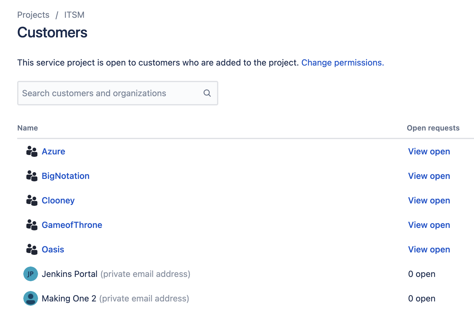

That’s everything you need to do to make that migration step easier when moving to the cloud. You will have all the list of customers you desired on the specific project as designed and the respective customers will be imported correctly into their designated organization. Back to the question of this article “is migrating customer users to Atlassian cloud easy”? Yes, the above steps, provides an easy path to alleviating those pain points encountered during migration and help you with those critical paths in your migration workflow.
