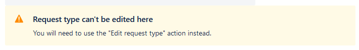

2. Set the request type of the ticket at creation
I am trying to setup this behavior using the automation system, but when I try to add the "Request Type" field to the ticket I'm given this error,

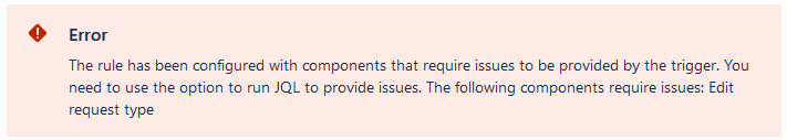

I then add "Edit request type" as an additional step to the automation, to set the Request type, but this results in needing to change the "When: Scheduled" step.
What JQL do I need to write for this basic action? Ultimately I'm just wanting to create a re-occurring ticket with a specific Request Type.
