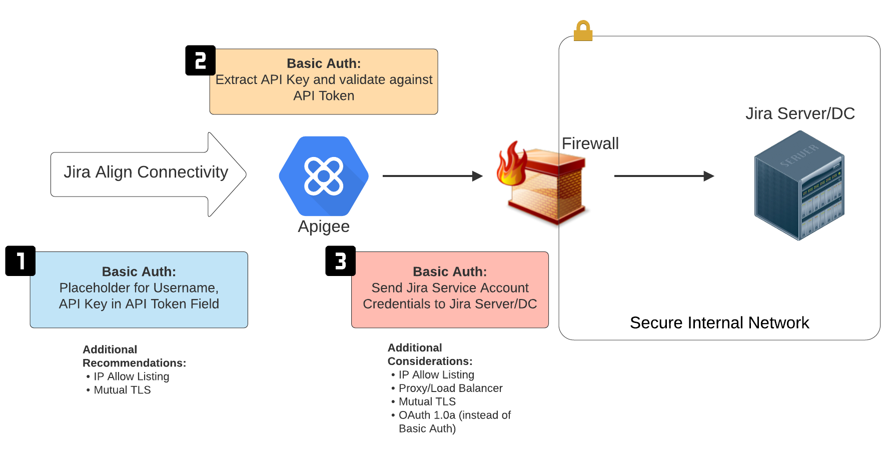

All REST API traffic will initiate from the Jira Connector for Jira Align.
The Jira Connector for Jira Align currently supports two authentication methods:
Basic Authentication
OAuth 1.0a.
The preferred authentication policy configuration for Apigee is the API Key, instead of Basic Authentication. This policy configuration allows Jira Align to send the API Key in the Basic Authentication header.
In the Jira Align administrator interface, the administrator would select Basic Auth and input the supported Apigee API key.
Using a custom Apigee integration, the Apigee tool would extract the API key from the Basic Auth header and validate it.
The next step in the custom Apigee integration would modify the inbound request to replace the Basic Authentication header with the Jira Service Account username and password, which is stored in an encrypted KVM and forward the request onto Jira Server/Data Center.
We also highly recommend configuring Mutual TLS and/or IP Allow listing at the Apigee policy level to establish multi-factor authentication policy. A sample IP allow list policy is covered in this article. As always, please review and validate these policies with your Head of IT Security before configuring in your environment.

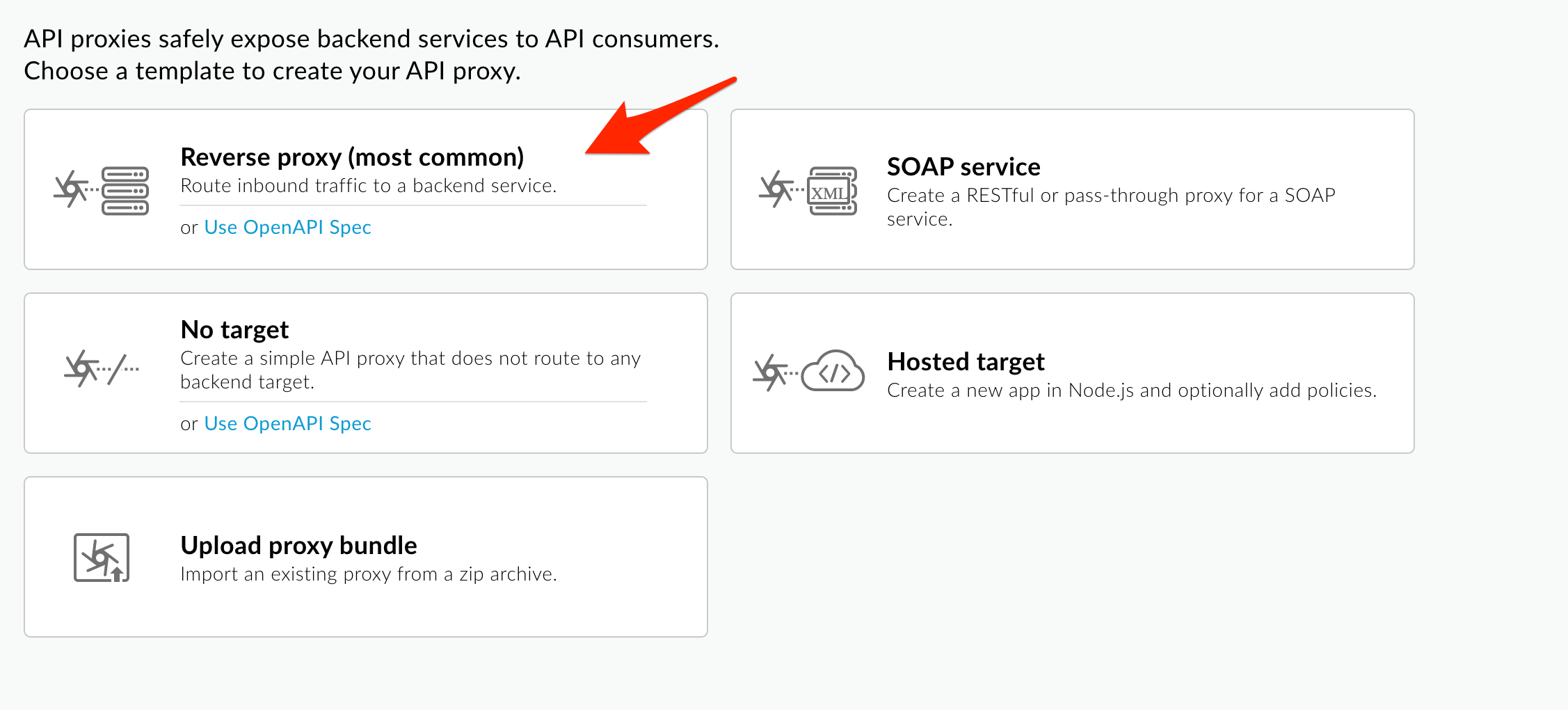

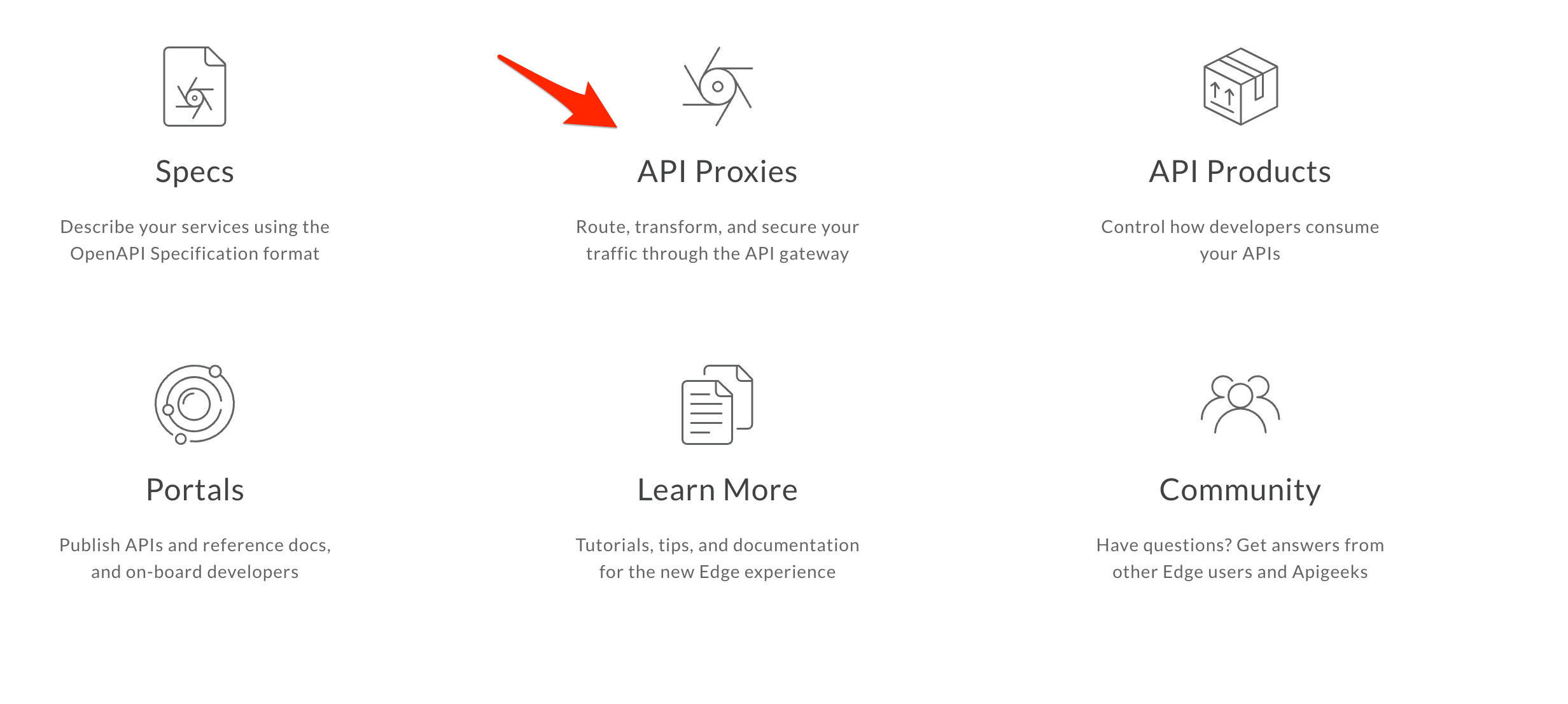

1.) Sign in to Apigee Edge and click on API Proxies.

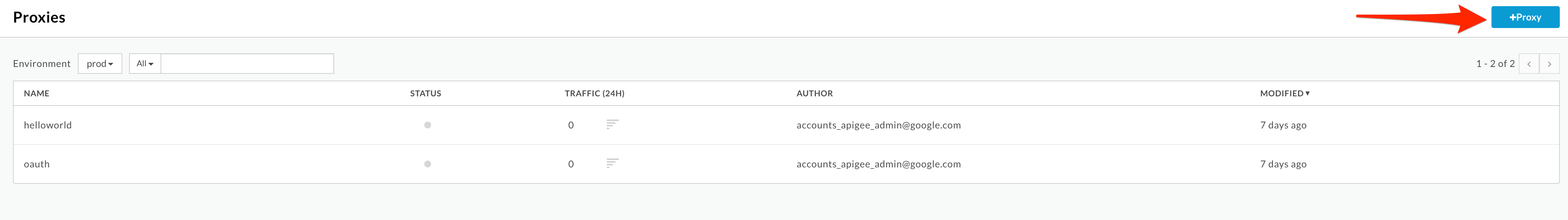

2.) Click +Proxy to create a new Proxy.

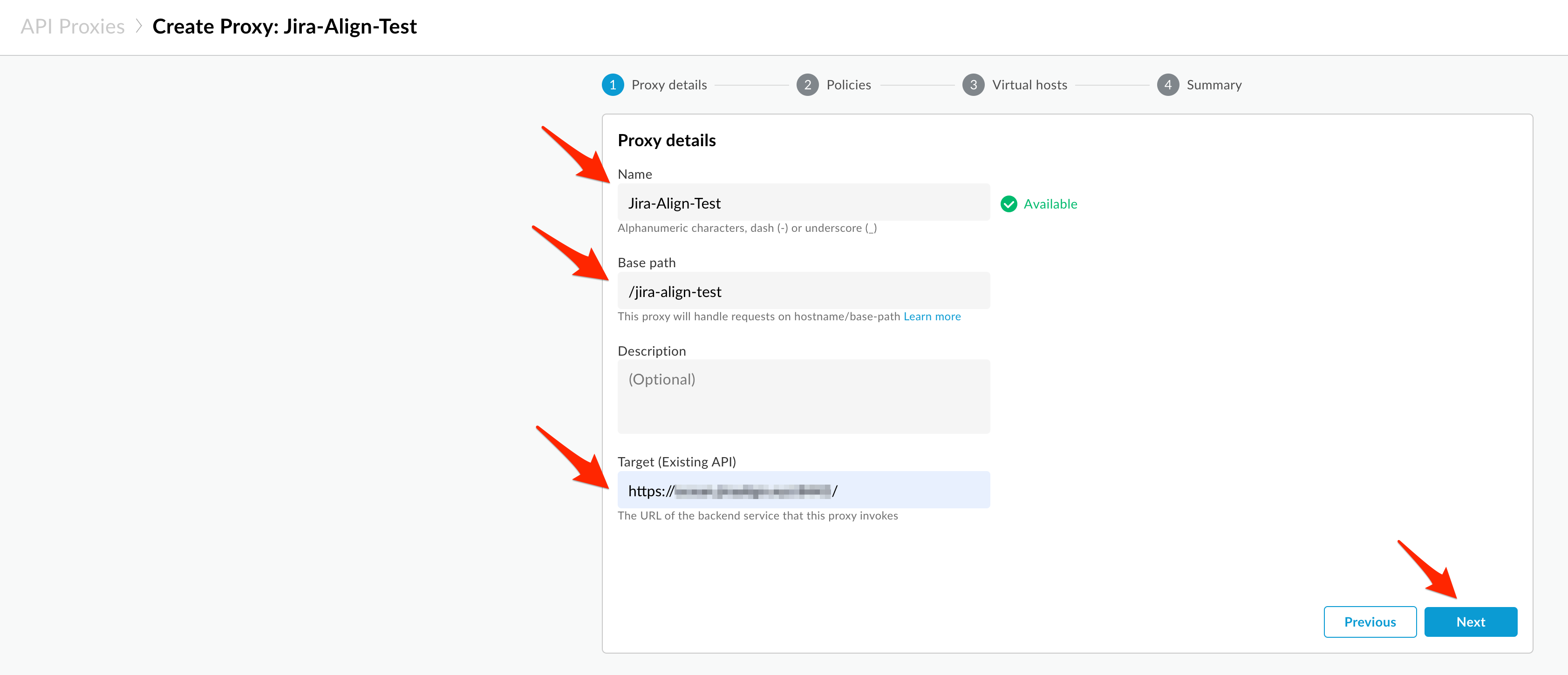

3. Select Reverse proxy.
4.) Fill in the Proxy name, the base path, and Target API (Jira site).
You’ll need 2 base paths (one for prod, one for test) to connect Jira Align to your Production Jira DataCenter and Test Jira DataCenter.

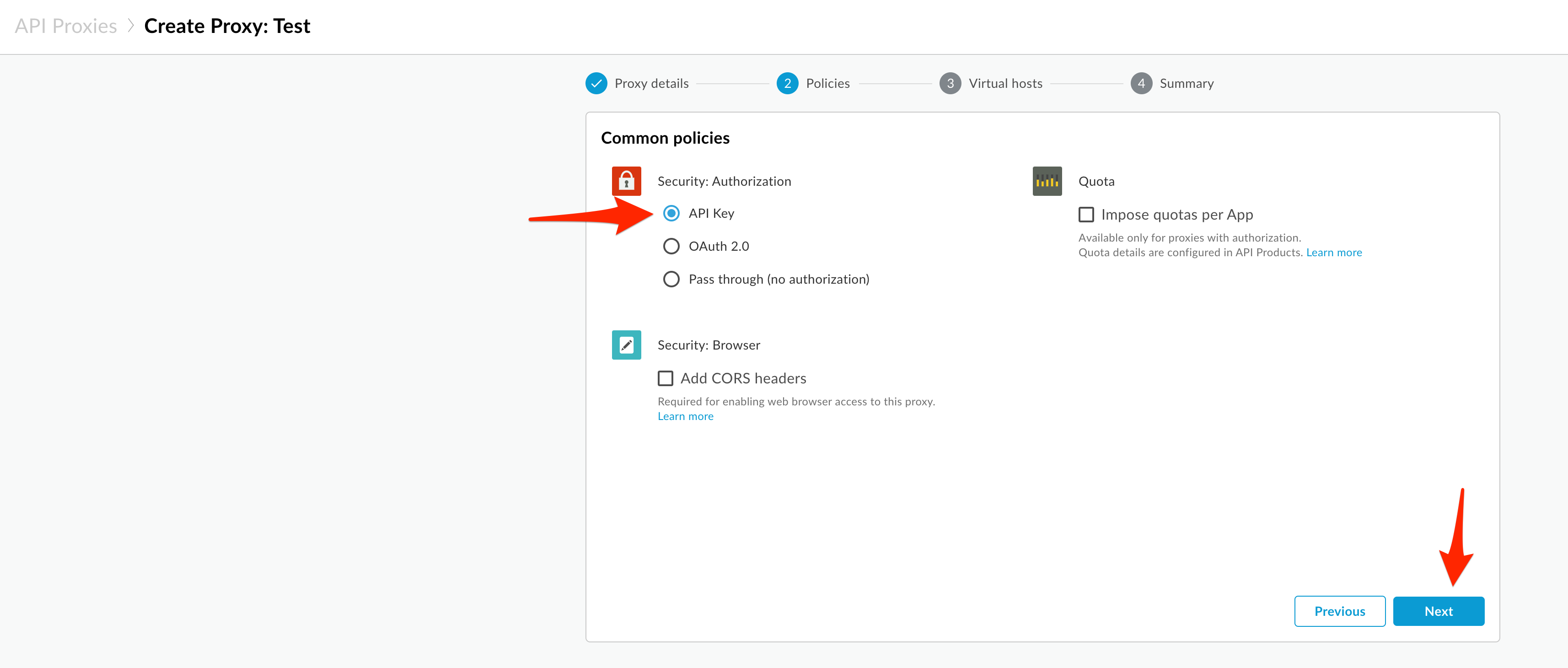

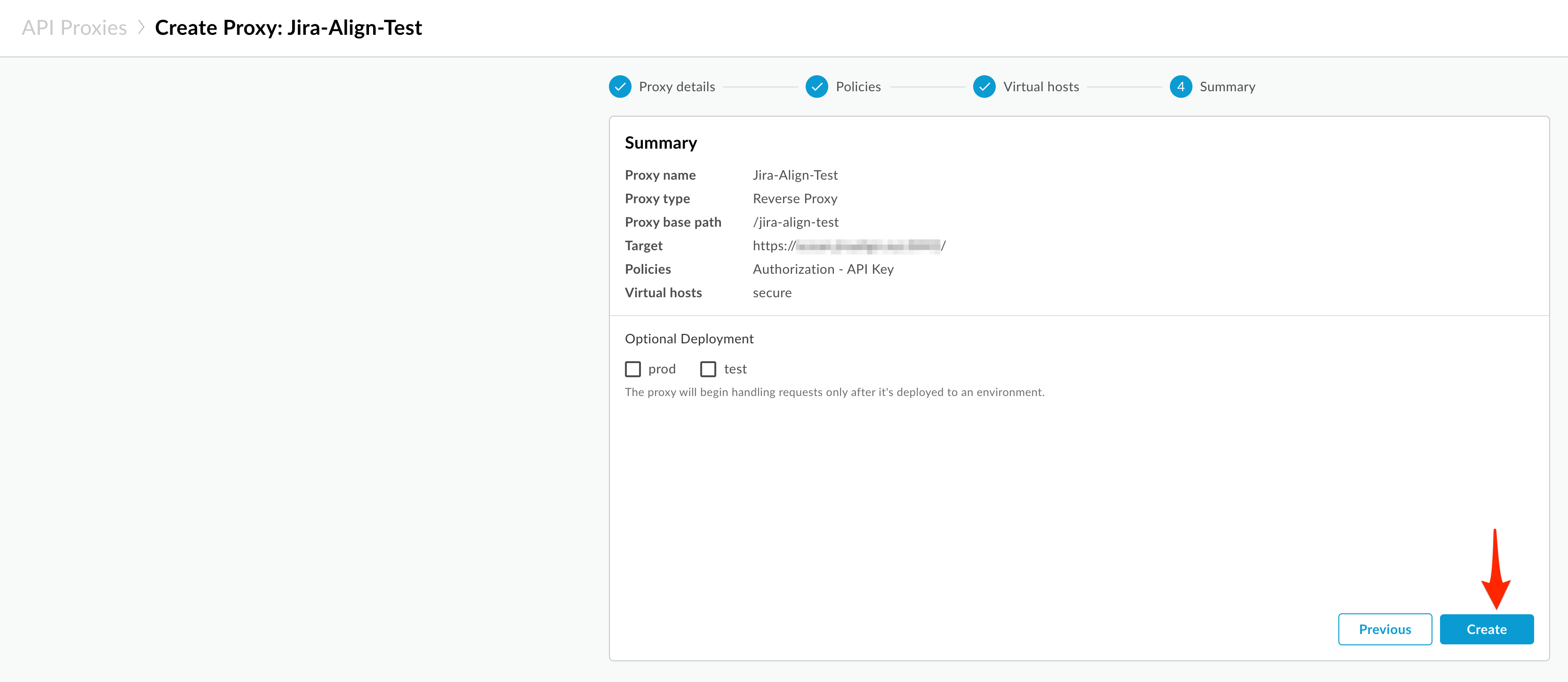

5.) Select API Key in the Security: Authorization options.

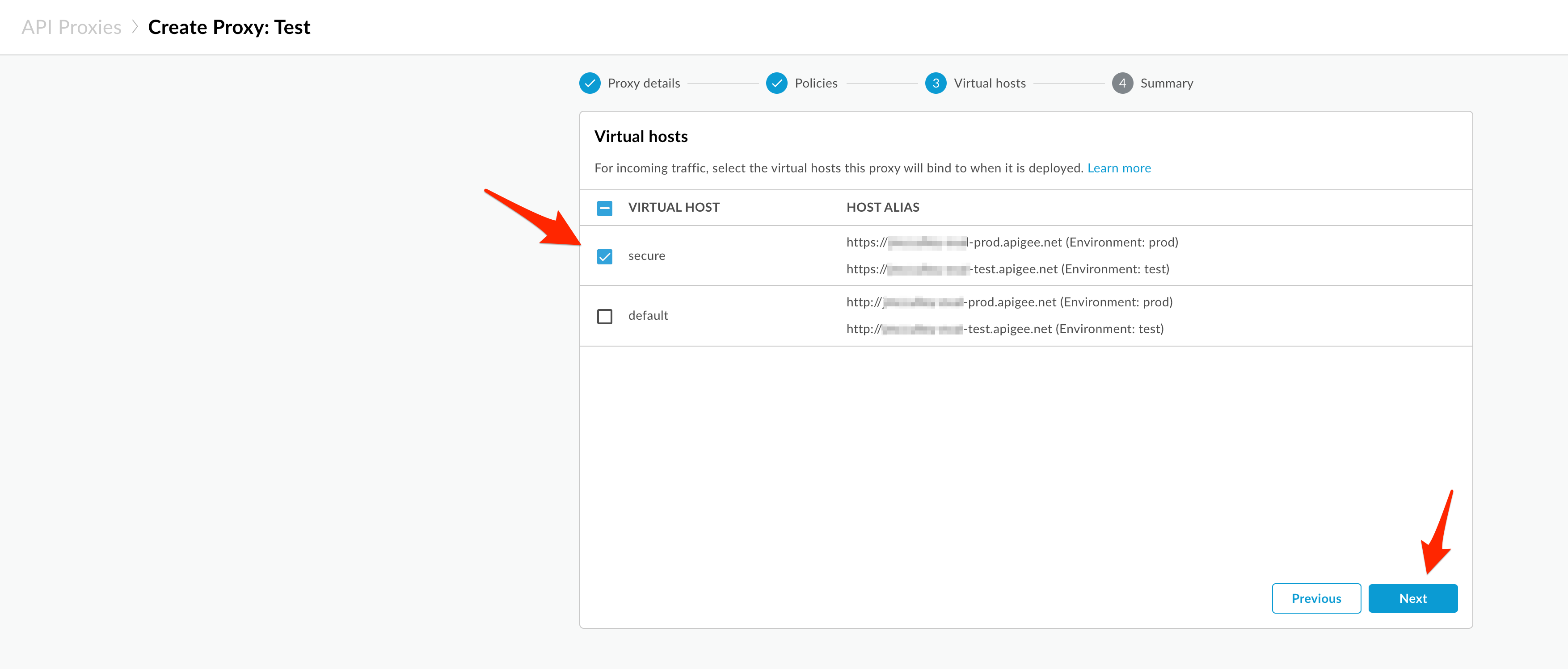

6.) Select secure in the Virtual hosts options.
7.) Click Create.

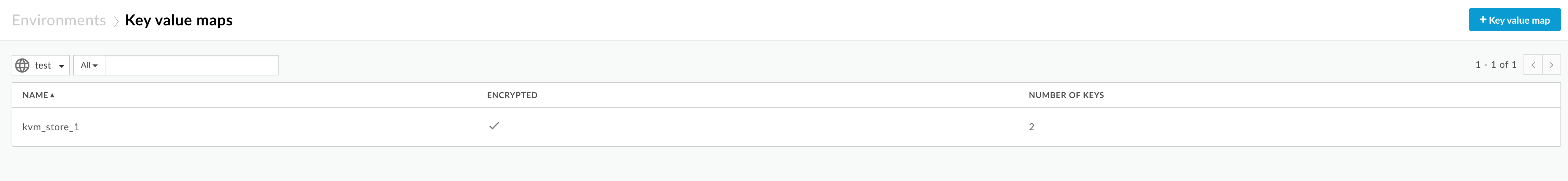

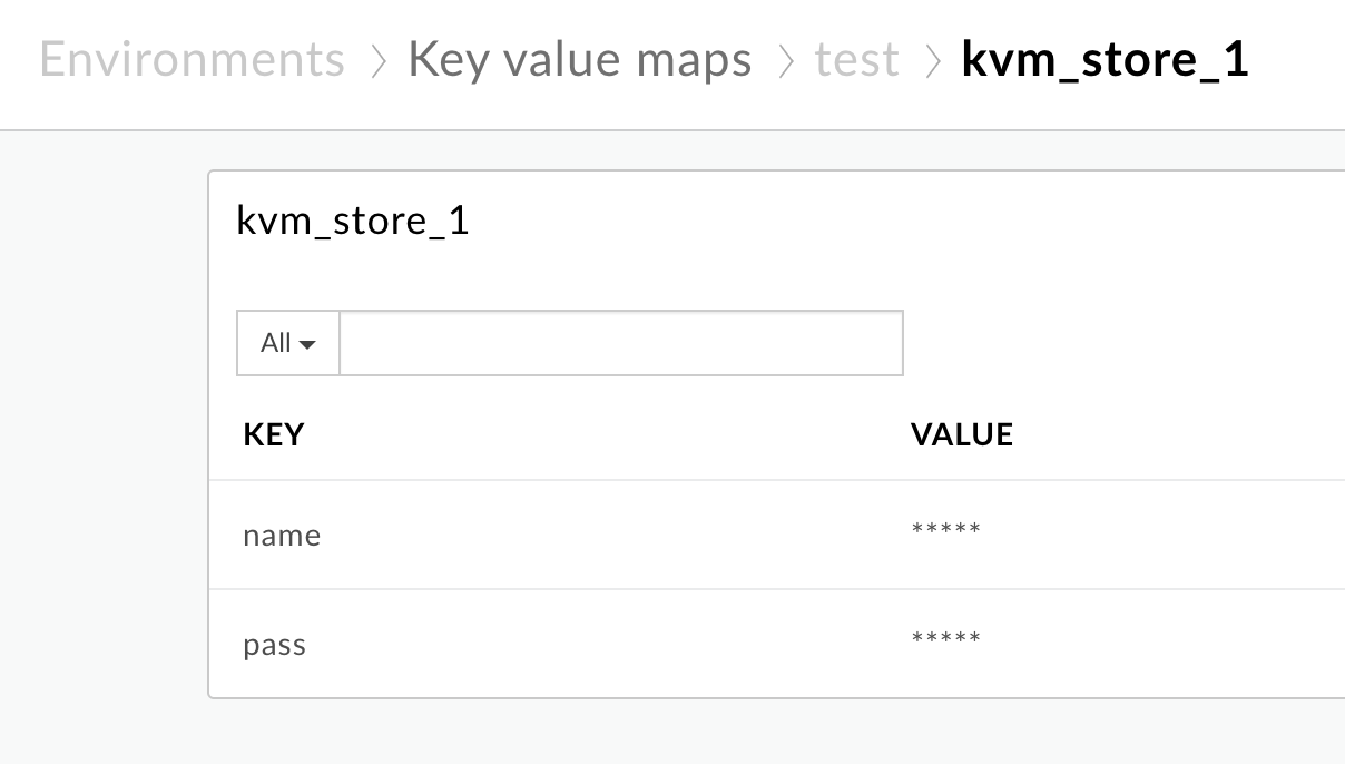

Create Key Value Map Store
8.) In the Apigee Edge tool, go to Admin > Environments > Key Value Maps.
Make sure to select the correct environment.
We recommend to use the test environment first.

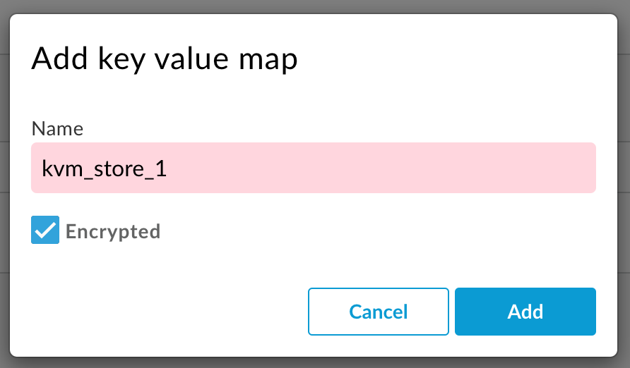

9.) Create Key Value Map.
Example:
kvm_store_1 (encrypted)
key: name, value: <jira-service-acct-username>
key: pass, value: <jira-service-acct-password>

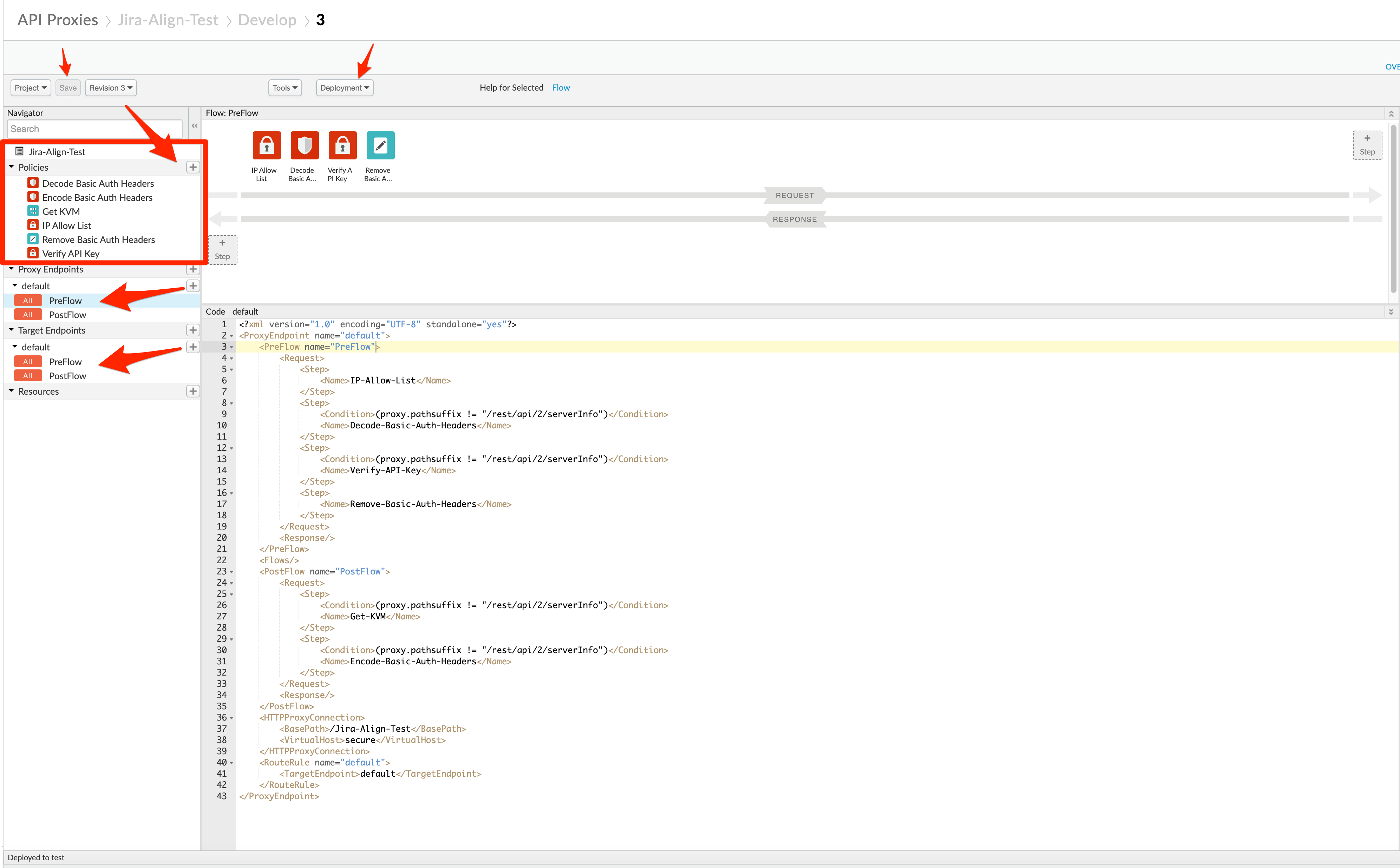

10) Navigate to Develop > API Proxies > Select your Proxy > Develop Tab.
11) Create these policies. You can paste the Verify API Key policy below over the existing one.

12) Place this in your Proxy Endpoint PreFlow and PostFlow after making any adjustments (such as BasePath).
<?xml version="1.0" encoding="UTF-8" standalone="yes"?>
<ProxyEndpoint name="default">
<PreFlow name="PreFlow">
<Request>
<Step>
<Name>IP-Allow-List</Name>
</Step>
<Step>
<Condition>(proxy.pathsuffix != "/rest/api/2/serverInfo")</Condition>
<Name>Decode-Basic-Auth-Headers</Name>
</Step>
<Step>
<Name>Verify-API-Key</Name>
</Step>
<Step>
<Name>Remove-Basic-Auth-Headers</Name>
</Step>
</Request>
<Response/>
</PreFlow>
<Flows/>
<PostFlow name="PostFlow">
<Request>
<Step>
<Name>Get-KVM</Name>
</Step>
<Step>
<Name>Encode-Basic-Auth-Headers</Name>
</Step>
</Request>
<Response/>
</PostFlow>
<HTTPProxyConnection>
<BasePath>/Jira-Align-Test</BasePath>
<VirtualHost>secure</VirtualHost>
</HTTPProxyConnection>
<RouteRule name="default">
<TargetEndpoint>default</TargetEndpoint>
</RouteRule>
</ProxyEndpoint>
13) Validate that this in your Target Endpoint PreFlow and PostFlow. (Do not paste over the existing policy.)

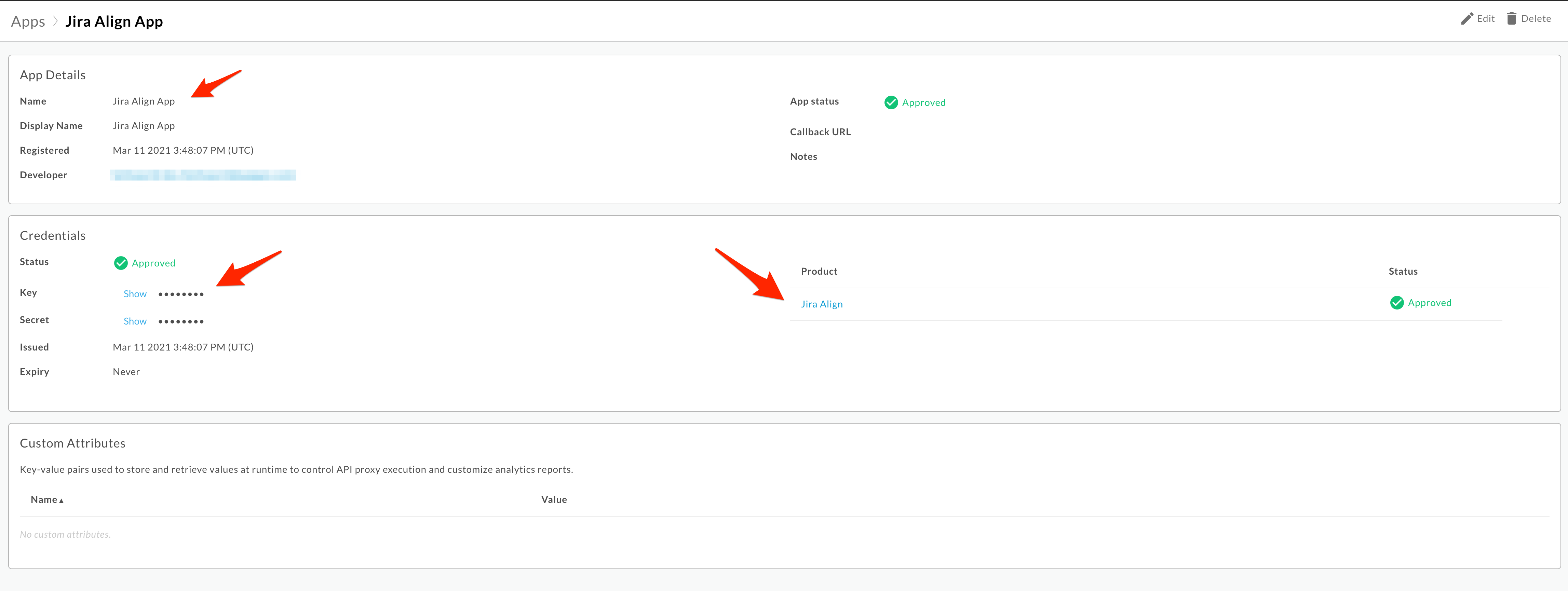

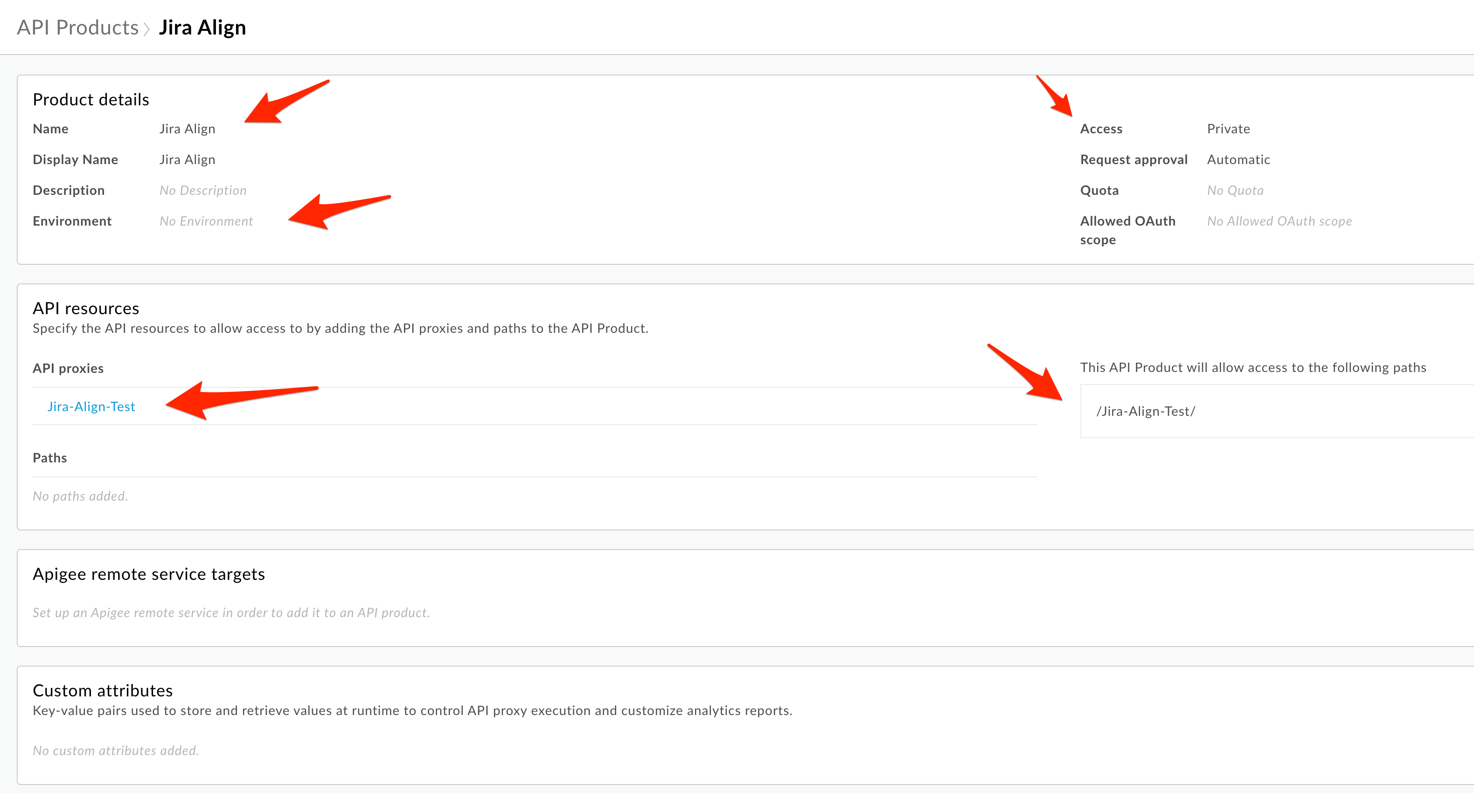

Create API Product and App
15) Go to Publish > API Products. Create new API Product.
16.) Give the API Product a name, access, environment(s), and add the recently created API proxy.
17.) Click Save.
18.) Go to Publish > Apps. Create new App.
19.) Give the App a name and add the recently created API Product.
20.) Click Create.
21.) In the newly created app, you should see the Key. Note that key for later use.

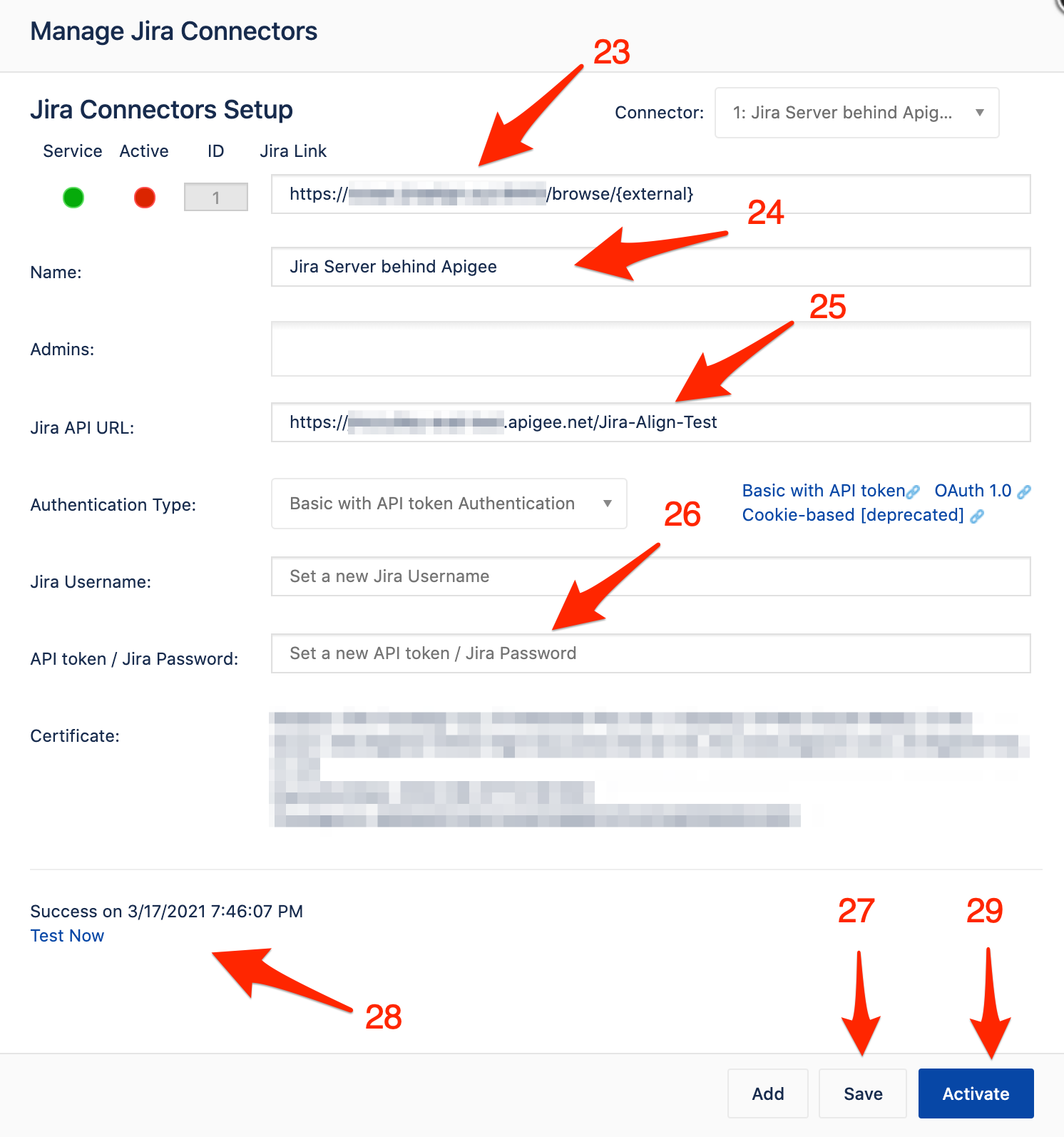

Setup in Jira Align
22.) Sign in to Jira Align as a super administrator, and navigate to Admin > Jira Settings > Jira Connectors.
23.) Enter the Jira Base URL (+ /browse/{external} ) into Jira Link.
24.) Assign this connector a memorable name.
25.) Enter the Apigee API Endpoint and base path from step 6 and step 4 into Jira API URL. (ex: https://example.apigee.net/Jira-Align-Test )
26.) Select Basic with API token Authentication as Authentication Type and set the username to something random and password as Key from step 21.
27.) Click Save.
28.) Click Test Now. (Note: You’ll need to close and open this box to see the Test refresh.)
29.) Assuming the test was good, go ahead and press Activate and Save.
30.) Then you can proceed with Syncing a Project.
