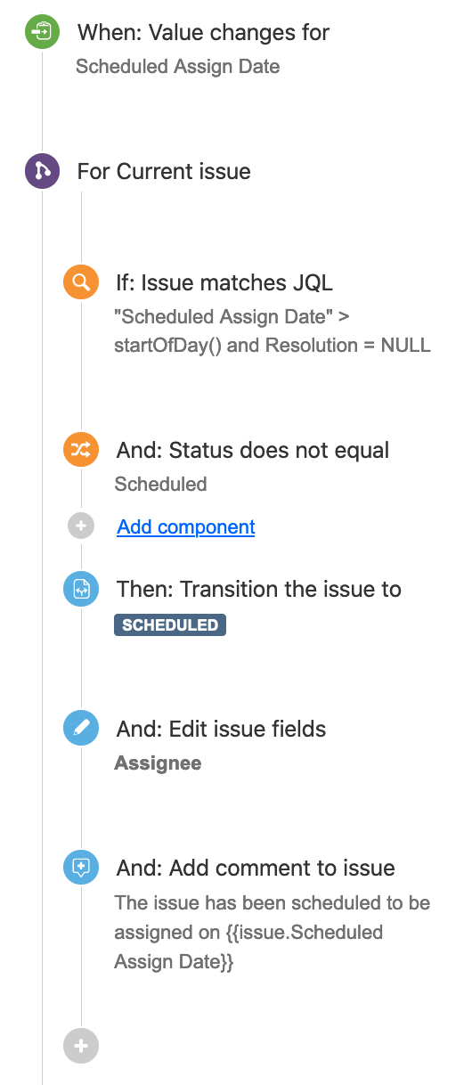

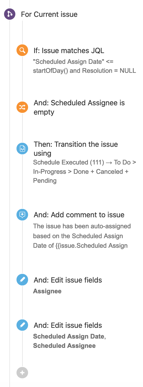

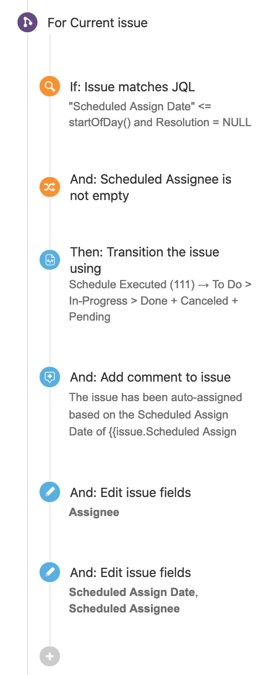

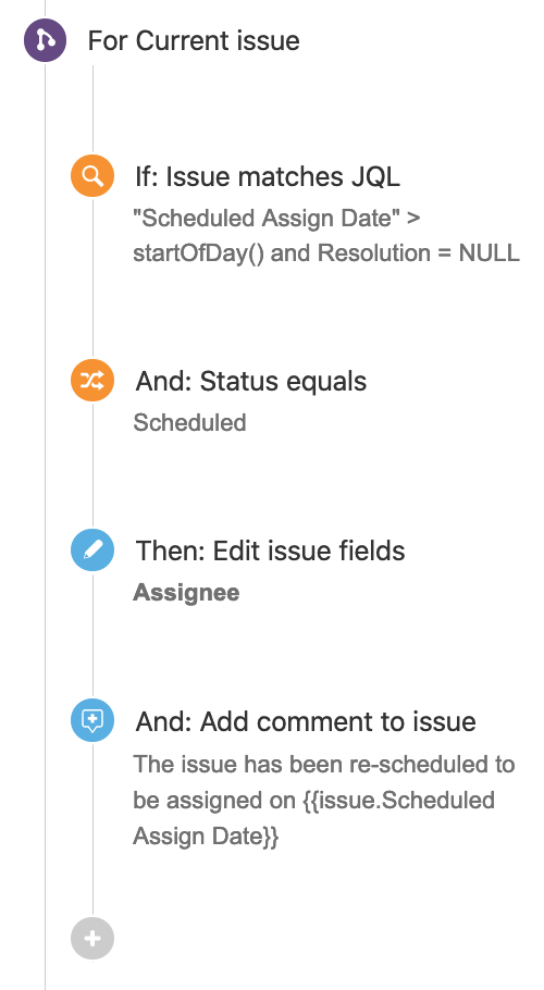

I have setup up Jira Automation to perform some changes on issues when I schedule them to be assigned on a certain date.
I've created the below rules for (create and edit issue).
The rule performs all the tasks correctly, but it takes anywhere from 45s to 1m to complete.
It is a little long and I was wondering if you guys had any ideas on how I could optimize this rule?
I tried merging the JQL with the Stats condition into one JQL, but that didn't help at all. I really don't know what else I could change to make this rule execution time faster.
I would appreciate any suggestions
