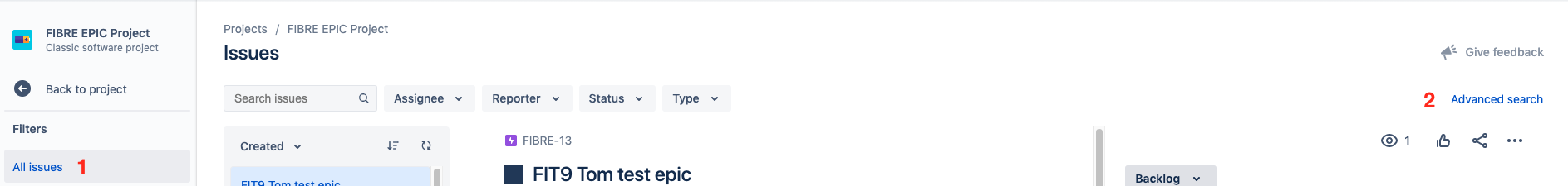

1. In Jira, select the project and click on All Issues
2. Click on Advanced Search

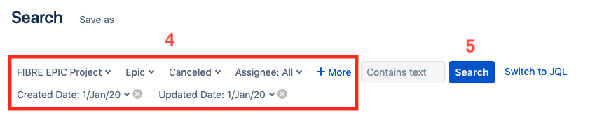

4. Make sure the following are selected:
- Project = Integrated project
- Type = Epic
- Status = Canceled
- Created Date = Date used in JQL to bring in data (check with Jira Align Admin for date if unknown)
- Updated Date = Date used in JQL to bring in data (check with Jira Align Admin for date if unknown)

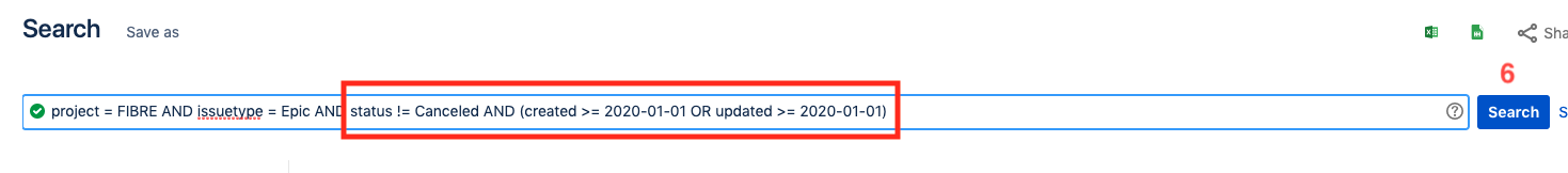

5. Select Switch to JQL
6. Change the following and then click Search:
- Status "=" to "!="
- The "AND" between the dates to "OR"
- Add parentheses around the created and updated dates
7. Confirm appropriate results are returned and the number of issues returned

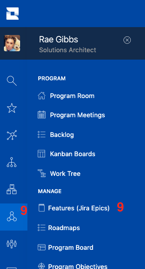

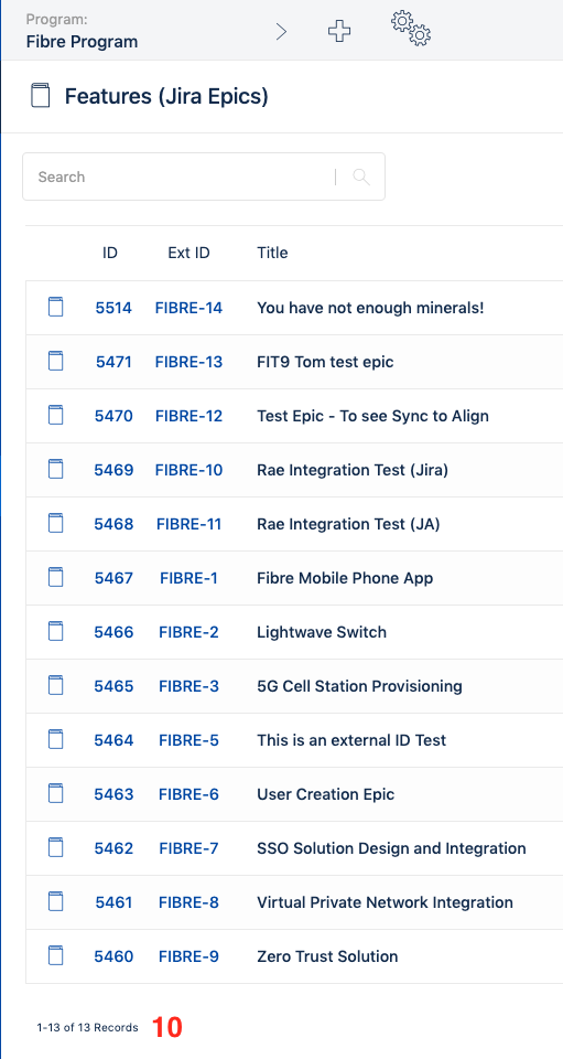

8. In Jira Align, select the associated program for the project in the top config bar and make sure there is no PI selected
9. Select Program and Features (Jira Epics) from the left hand navigation menu
- Note: "Features" may be called something different if it was renamed in your Jira Align instance
10. Confirm the number of items returned matches the number of issues returned in step 7

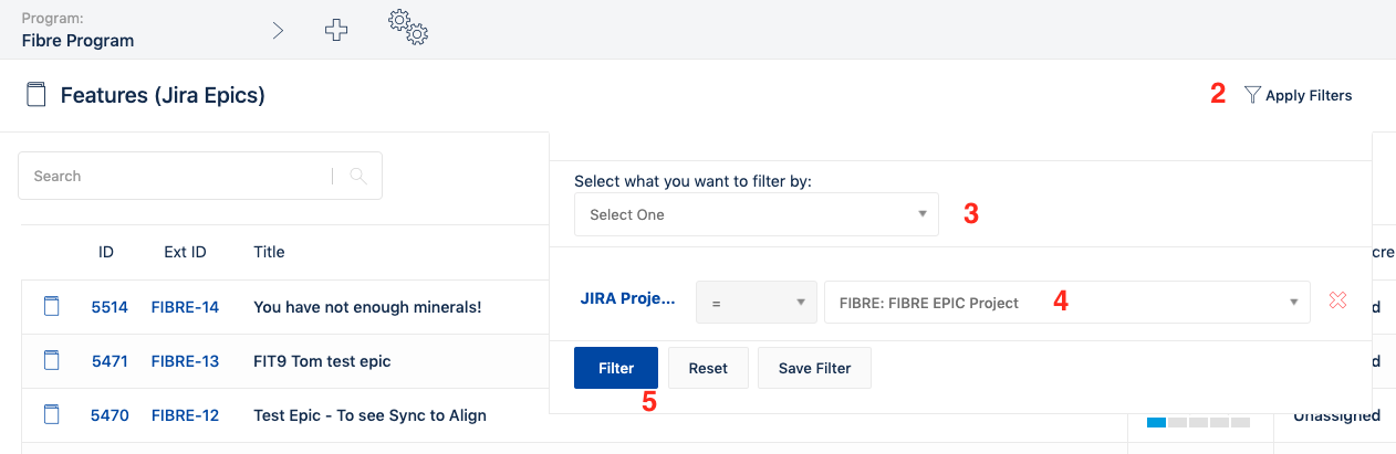

12. On the Features Grid, click Apply Filters
13. Select "JIRA Projects" from the dropdown
14. Select the Jira project used in step 1 above
15. Click Filter
16. Pick up with step 10 above

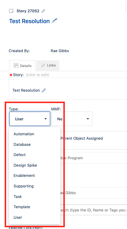

- Things to keep in mind with stories if counts are off:
- If there have been any custom issue types mapped, these sync over as stories
- For example, Tasks from Jira would become a story in Jira Align with story Type listed as "Task"
- In this case, issue type of "Task" would need to be included in the Jira query

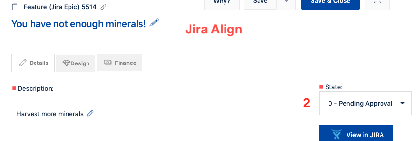

1. Start with an epic in Jira in the first status of the workflow
2. Confirm the state of the feature in Jira Align matches the status of the Jira epic
3. Update the Jira epic to the next status in the workflow
4. Confirm the state of the feature in Jira Align updated as expected

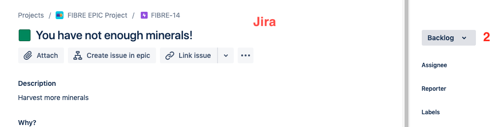

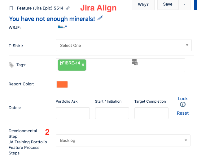

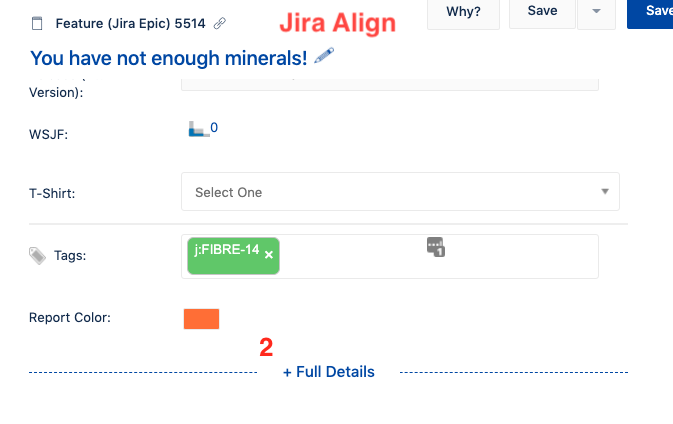

2. Confirm the process step of the feature in Jira Align matches the status of the Jira epic
- Full Details must be selected on the work item in Jira Align to view the process step
4. Confirm the process step of the feature in Jira Align updated as expected
5. Continue with steps 3 and 4 until all statuses have been selected
