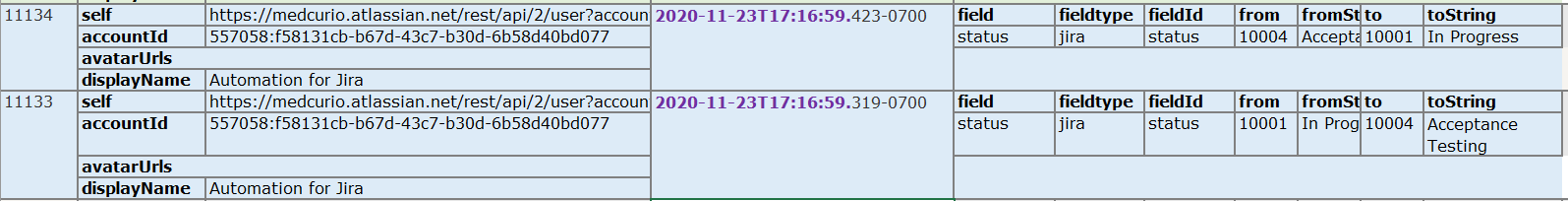

I believe that I have all the proper setup in place but the status of my Jira issue is not updating when I take actions in Github ... or rather ... it the status of the card isn't staying updated. From looking at the "changelog" information returned when all call a GET for the issue via the JIRA REST API, I can see that the status is advancing and then seems to immediately get reverted milliseconds later to the previous status. The advancing of the status and the reversion to the prior status are associated with an"Automation for Jira" account.

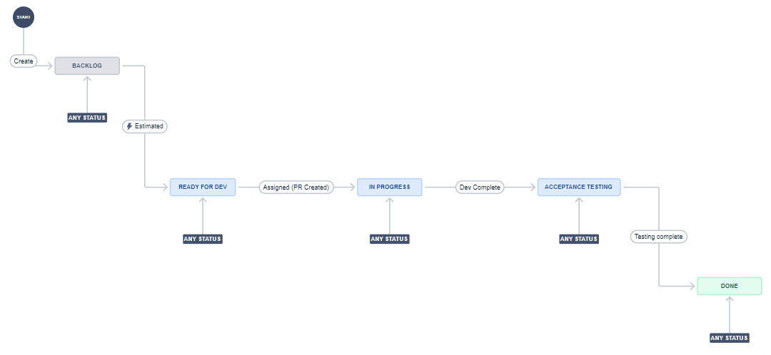

Here's workflow that I have setup for my Next-Gen project:
In my next-gen project I have a project-level automation rules setup to transition:

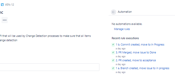

In my card, I'm able to see that the automations are getting triggered:

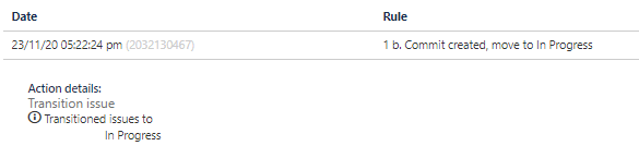

Also, the Automation also shows "success" in the history log:
Here's information that I'm seeing in the "changelog" portion of JSON when I call .../rest/api/2/issue/{{issue-key}}?expand=changelog
JSON details:
