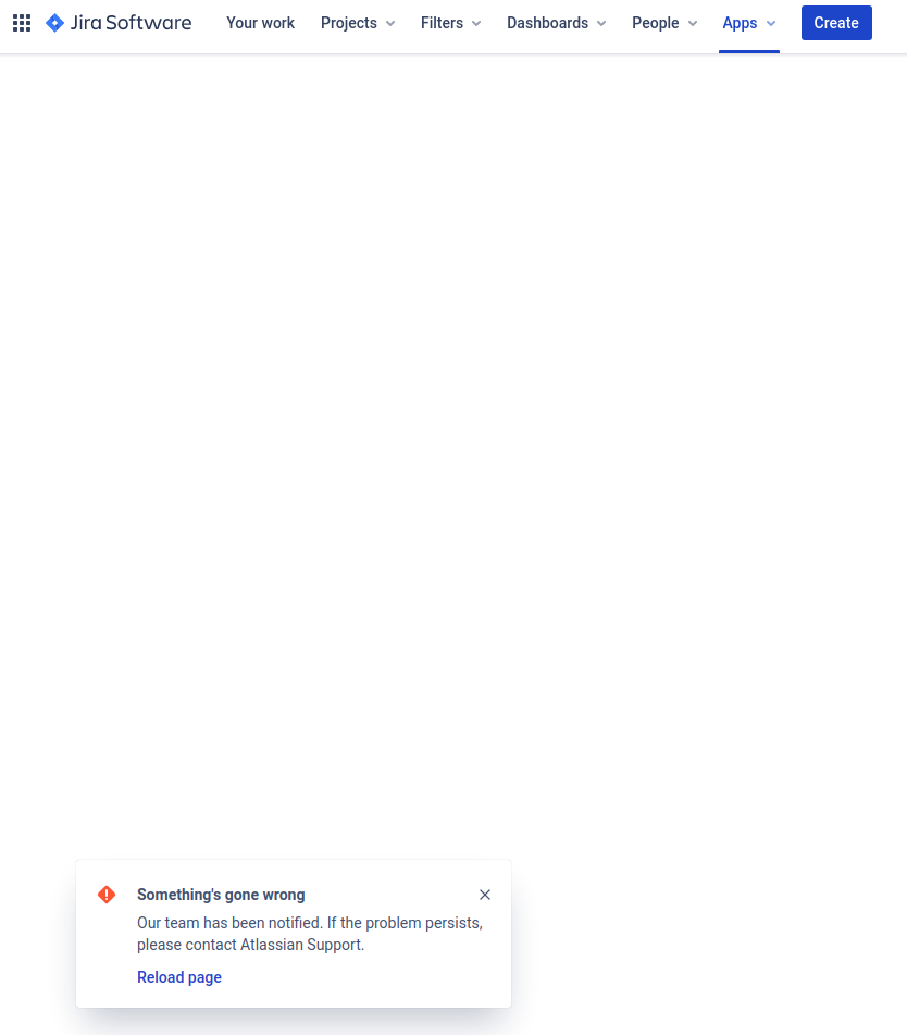

Actual result

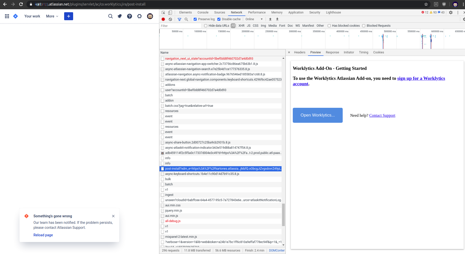

Page stays loading for a while, ends up erroring:
Inspecting the network calls, the post-install call to the application succeeds, and if I preview it and click on the "Open Worklytics" the app connection is performed successfully.
But up in the network calls there's one 404 error:
Request URL: https://xxxxxx.atlassian.net/rest/api/latest/user/properties/navigation_next_ui_state?accountId=yyyyy
Request Method: GET
Status Code: 404
Body:
{"errors":{},"errorMessages":["The property navigation_next_ui_state does not exist."],"httpStatusCode":{"present":true}}
So while the connection is fine, looks like the UI breaks and doesn't renders the post-install iframe.
