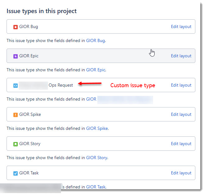

The closest I have come to accomplishing it was from this post here where I went through the steps and created what I thought was the correct process, but I'm certain I have gone onto a different tangent as what I've done is created all new Issue Types for the existing project (basically the project name followed by Task, Epic, Spike, etc.) because I gathered that's the only way I could create a custom Issue Type and then allow it to be separate from the other Issue Types and their fields.

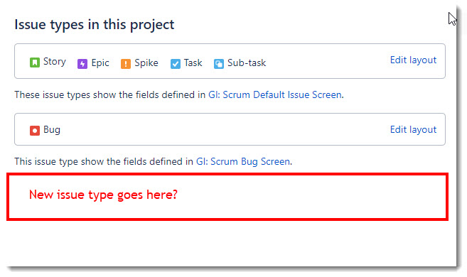

The more I think about this, as I'm typing, the more I'm thinking what I need to do is add the new Issue type as a separate Field Scheme?
See image below for what I *think* I should be doing...
And what I ended up doing looks more like this (using a test project I set up):
What he wants is for basically all of his current Issue Types to be left alone and to just add the Ops Request, with it's own customized Fields.
