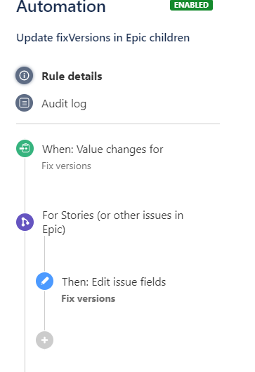

I would like to have an automation rule that updates all children (stories, defects, tasks) in an Epic when the fixVersion on the Epic is changed (including the first time it's set.)

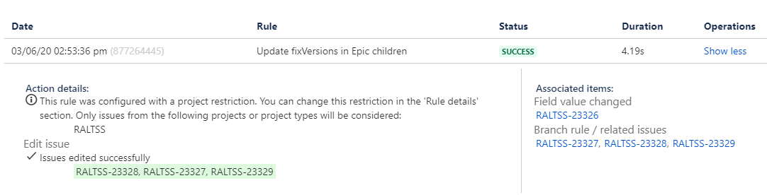

I set up a rule, and the audit log indicates that it ran successfully on the expected ticket numbers, but when I look at those tickets, I'm not seeing the fixVersion populated. (I waited 10 minutes, just on the off chance that it didn't happen immediately.)
Can someone help me out? What have I done wrong with this rule setup? (I'm assuming the "When Value Changes" trigger also includes changing from blank to populated; is that wrong?)
