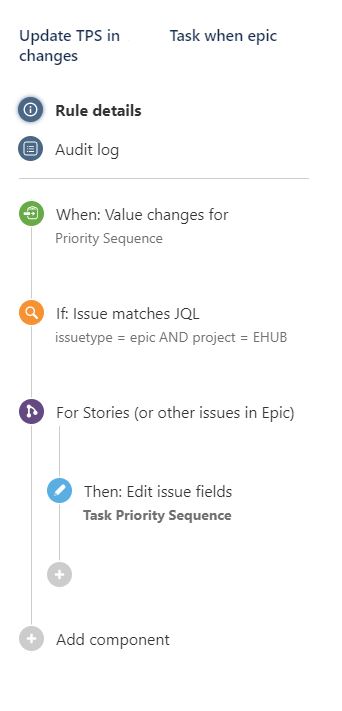

I was trying to implement the following automation in my cloud using Automation rule:
1. We have issuetypes of epic, task, and sub-task.
2. There is a number field called priority sequence (PS), as a number from 1~9, for each issue type.
3. For task, we have field called task priority sequence (TPS), formatted as [epic's PS][task's PS]. For example, if an epic's PS is 3, and a task under that epic has PS of 5, then the task's TPS is 35.
4. Similarly, for sub-task, we have field called Sub-task priority sequence (SPS), which has three digits and formatted in a similar way as TPS. Using the above example, if a sub-task under that task has PS of 9. then the SPS for the sub-task is 359.

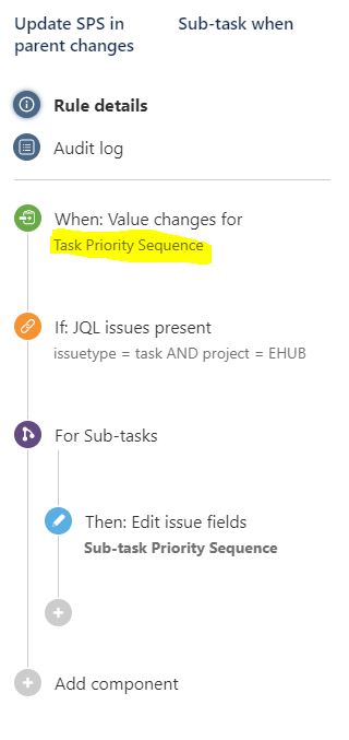

I want to have automation rules that update TPS and SPS each time when the PS of parent/epic changes. So far, the rule works for TPS. But I have a similar one in place for SPS, it does not work when the PS changes for the epic.
<Update SPS>
I am guessing that it is because when PS in the epic changes, the TPS will changed by automation, but such changes by automation does not count for "value changed", so that the rule on SPS, which watches the changes on TPS, does not respond or update SPS.
I was wondering if it is the case and how could I make it work?
If automation rule doesn't work in my case, are there any other methods I can try?

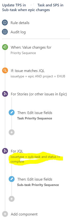

Update:
I figured out a way to do it is through changing the epic:
But going through all sub-tasks is VERY slow, and I was wondering if there is any better way to do it.
