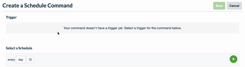

1. Create your report's trigger.
This is how your Report knows when to run. Currently, it only works on a schedule*, so you need to open Butler from either the top of your board or your board's menu and navigate to the Calendar tab on the left. Once there, choose the first option under Select A Schedule, which says Every Day. Click the filter icon next to the box containing Day and set the time you want it to run. Once your time is set, click the + icon to add the trigger to our Report.

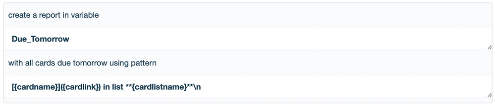

3. Set your Report to pull tomorrow's due items.
We're going to do the exact same thing we did in the last step, except name the Variable Due_Tomorrow and choose items due tomorrow from the Filter icon menu. Use the exact same Pattern for the content we did before, which is made all the easier because Butler remembers your previous action's information. You don't even need to type it all again. Easy!

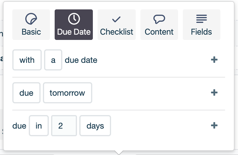

4. Set your report to pull items due in 2 days.
You know the drill! Name your Variable Due_2_Days and choose items due in 2 days from the Filter menu.

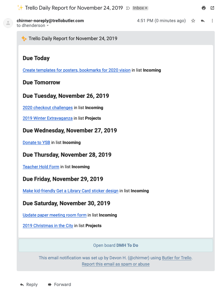

And the rest follow the same pattern. Still confused? I understand! So, here's a screenshot showing what the end report will end up looking like:
Hopefully this helps you piece together what content turns into which end result.

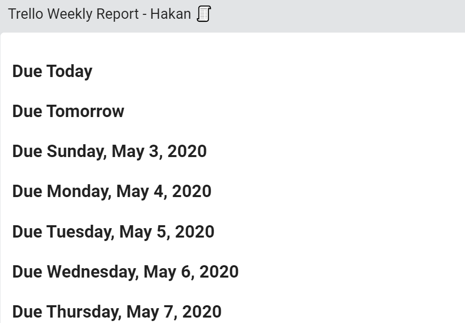

Use this to setup reports for my team members but they came up blank in the email, please see below. How do i correct this?Geoff.PNGHakan.PNG

My report ended up empty as well.  Sure I missed something obvious. Grateful for any help

My daily report updates show up as blank emails each day. The content of the report is missing. However, when I run the command to test it, I get a messaging saying: "I created a report with 11 cards in variable {$test report name}"
Like Deleted user likes this
Deleted user
April 8, 2021
Same for me, blank report always, no matter how simple should be, always blank. Anyone has any idea?
Douglas Ribeiro Lopes
August 6, 2021
Hi
That happened because you dont have any card with due date in these dates.
