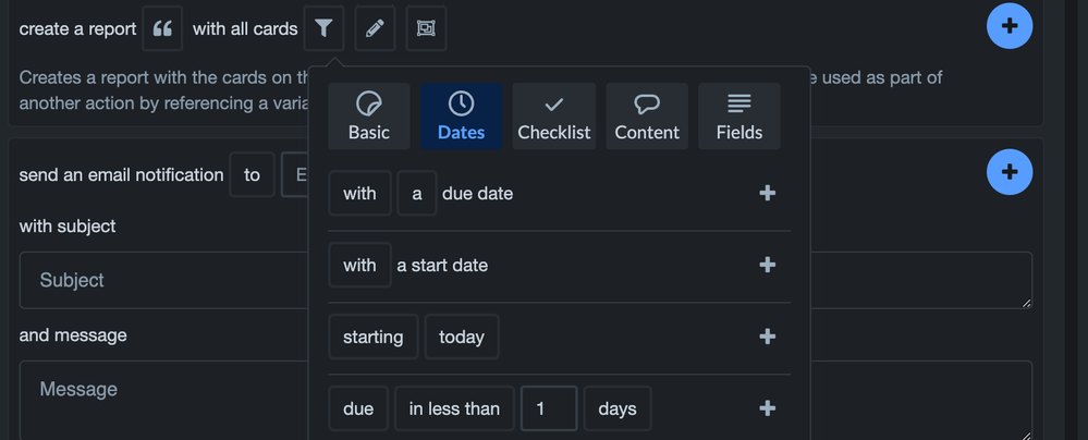

Rick Clark
March 26, 2025
My automation that moves cards based on a complete due date doesn't work with the items marked complete without a due date and now I see there's no option for automation that will filter cards based on if they're complete. here's my legacy automation
"every wednesday at 2:00 pm, create a report in variable "Done" with all cards in list "To Do" with a complete due date using pattern "- {cardname} - {cardcheckliststate}", send an email notification to "****" with subject "{boardname} Report for {date}" and message "These are the items that were done at {boardname} recently:\n\n{$Done}", and move each card in list "To Do" with a complete due date to the top of list "Completed""
This is showing no option to filter based on complete status

Rick Clark
May 8, 2025
@Kelly GabelIt does still work... sort of. I can't create a new automation of the same type which means I can't edit it very much. but really what's broken is that now people can mark it complete without there being a due date. it used to be that people would have to add a due date to mark it complete, but now that people can mark it complete without adding a due date, it gets missed by the automation. It seems like it would be easy enough to try to teach people that they must add a due date before marking it complete, but that seems to be a challenge for some people unfortunately.
