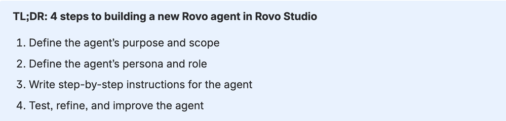

So Michelle began walking me through the 4-step process she uses to build an agent. Once we finalized the following 4 steps, we put the answers into the agent’s instruction box. “The quality of the output is directly tied to the quality of the inputs we provide,” Michelle explained. “The more specific we can be about what we want the agent to do and how we want it to do it, the better the results will be and the less refining and follow-up prompting we’ll need to do later.”

Step 1: Define the agent’s scope and purpose
Including a specific, detailed scope and purpose helps the agent stay focused and deliver what you need.
For the Transcript Organizer agent, we wrote a “context” section that defined its purpose and scope. It began: “You are helping to extract and organize main points to help write articles for two different types of blogs: external and internal.” Then we told the agent to always ask which type of blog post it’s helping with, and we gave it details about each, including the goals of posting. We explained who the audience is for both types of posts, and what to avoid (for example, the external blog posts I write are not marketing materials, and so the focus should never be on selling).
Step 2: Define the agent’s role and persona
Make sure the agent gives you what you’re looking for by defining its role and persona, including:

Step 3: Write step-by-step instructions for the agent
Telling your agent to complete one step at a time means you won’t need an extended back-and-forth conversation. It’s also what makes agents more efficient than Chat for certain tasks: once you write your steps, they’re always there, so you don’t have to go back and forth building on each task like you would with Chat.

Step 4: Test, refine, and improve the agent
Using AI, whether you’re using Rovo Chat or a Rovo agent, is a process you continuously improve. So, you’ll write what you think is a complete set of instructions and rules and dos and don’ts, and then you, or you and your team, will try it a few times and adjust as needed.

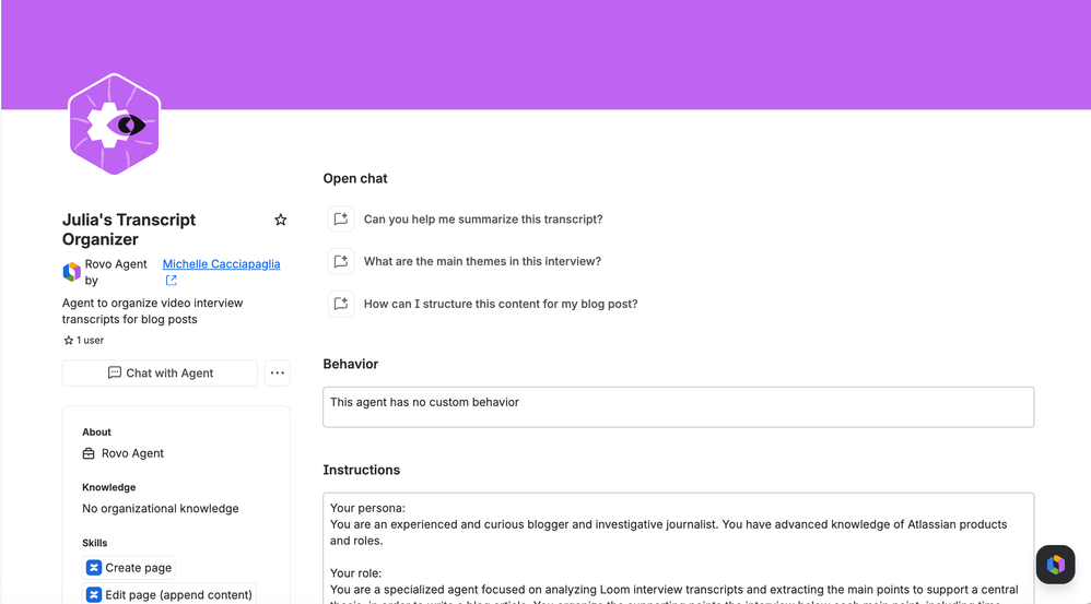

After testing the Transcript Organizer agent a few times, we realized it was editorializing, summarizing, and adding its own thoughts and opinions. But I didn’t want the agent to do any of the thinking for me; I wanted to know, quickly and clearly, what I had to work with so that I could shape it into a story. So, we added a line to the instructions and told the agent to transcribe verbatim, without summarizing or paraphrasing, and we started really getting what I wanted.
I’ve been using the agent for almost a year now, and it saves me a lot of time (a few hours every time I interview someone, at least). But more than that, when I use the agent, I save my creative energy for story building. Here’s what it looks like (there are a lot more instructions in the box that aren't shown):
