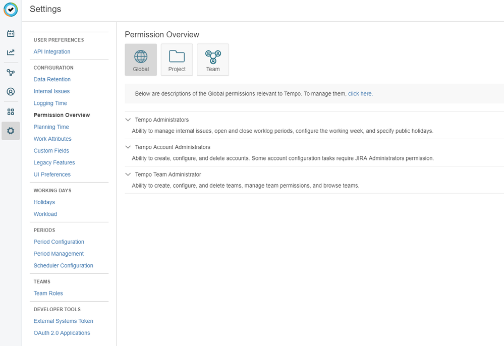

Hi Suzanne and thanks for you reply.
First, I can confirm that the user I'm trying to add is an active jira-user.
Regarding viewing the worklogs, and permissions, as I said, I was made Jira site admin by my manager.
That said, I am not sure how to physically check whether I have the various degrees of permission you describe (view team worklogs, view all worklogs, browse project). What I know from experimenting with the functionalities though is that I can see the other 3-4 users that are also working on the project, and can view their timesheet/tempo reported hours.
In the screenshot below, I can see the three icons and matching dropdowns with the functionalities that you describe.
Dear @Susanne Götz _Tempo_,
I received support from the support team and they sent me a FAQ article which cleared the problem away:
https://tempo-o.atlassian.net/wiki/spaces/KB/pages/231604228/Necessary+plugin+permissions+-+cloud+instances
Though I was a site-admin, my company's cloud hadn't configured the site admin role to be granted the specific "Browse user groups" which was in turn causing the issue I described.
Thanks for your help and suggestions to clear the problem.
