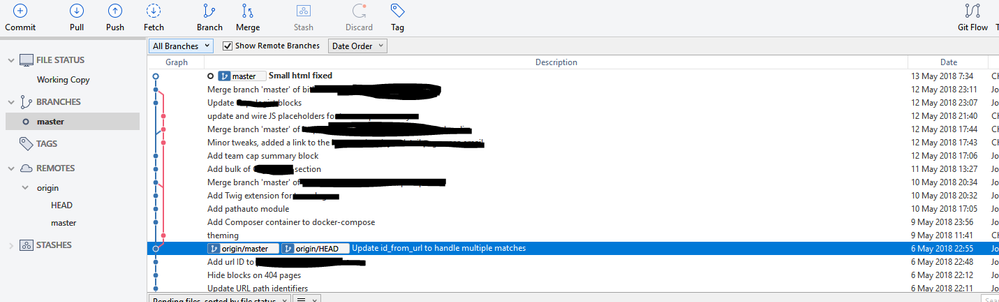

A few days ago the remote origin/master flag stopped moving along when I commit/push
Everything is working just confused why this is happening or what the implications may be.  See screenshot.  The "origin/master" just stays at May 6 as we keep marching along.

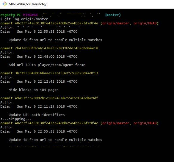

I've ran a fetch a bunch of times, it had no effect.  I also checked the log as you suggetsed, and it shows the entries from May 6 back.

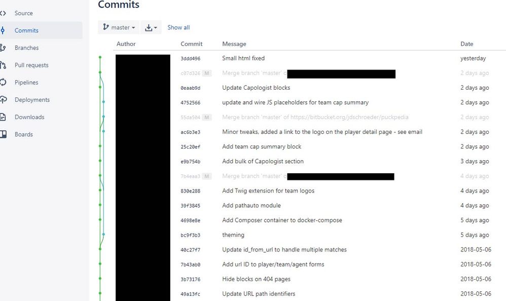

BUT, the repository in Bitbucket (the origin/master, right?) shows all of commits right up to May 13.

OK, if git fetch doesn't seem to be picking up the new commits then it doesn't sound like its a specific Sourcetree issue.
It sounds like fetch runs but does nothing?
What happens if you clone the repo again? Is it possible your current copy is corrupted in someway
