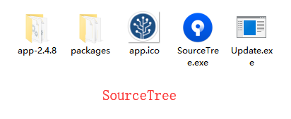

Hi Michael,thank you for your reply!

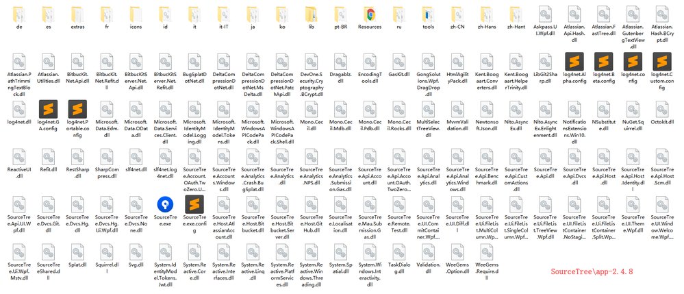

after I run the installer normally,I can get things installed,contents as the pics shown:
but both of 'SourceTree\SourceTree.exe' and 'SourceTree\app-2.4.8\SourceTree.exe' are not working whether run normally or run as admin.

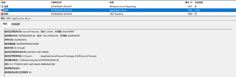

Hi Michael,there's no 'Atlassian' folder created in %localappdata% directory,so I can't provide sourcetree.log,but I find 3 event logs during excuting '%localappdata%\SourceTree\SourceTree.exe':

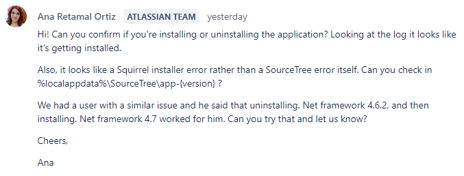

According to the event log and Ana's solution(captured from another post):

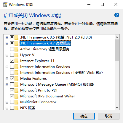

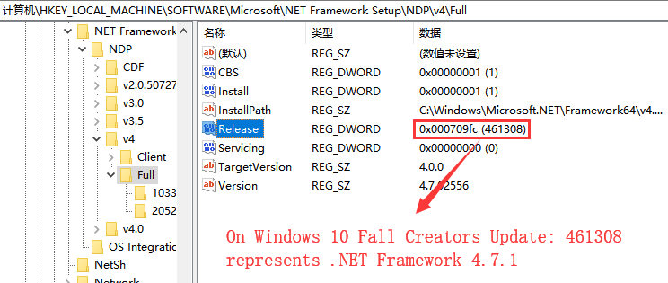

I think the problem is that the version of .net framework is too low(v4.0.30319),but when I install the latest version file,the system prompt that I have already installed the .net framwork v4.7.1 or later,I checked it out specially:
what can I do to solve this problem... Thanks Michael~~~

With respect to the version numbers its worth remembering that the Framework runs on top of the CLR so ever Framework since 4.0 runs on the 4.0 CLR.
I reasonably certain the installation has completed, the issues is with Sourcetre vs .NET.
I know from personal experience there can be issues with getting the .NET 4.7.1 framework 'acknowledged' by the OS until there has been a reboot.
