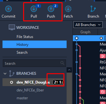

Good evening everyone.
I'm having this problem with SourceTree. After clicking on Pull/Push, the indicators disappear. But after refreshing, or clicking on Fetch, the Pull/Push indicators return, as if there were still something to receive and send.
What should I do?

Douglas DelaBite
December 11, 2025
Hi Ram / Tobi!
Thank you for your response.
The version I'm using is 3.4.27, updated yesterday.
And yes, I did a "git push / pull / status / fetch" via terminal and the problem persists.
I even deleted the local branch and fetched it again from the origin, and the problem continues.
The problem started after I merged another branch into mine. The merge was normal, but these indicators started appearing after fetching.

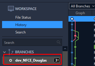

And it's random. Now it's indicating that I have a push to do...
See the screenshot.
