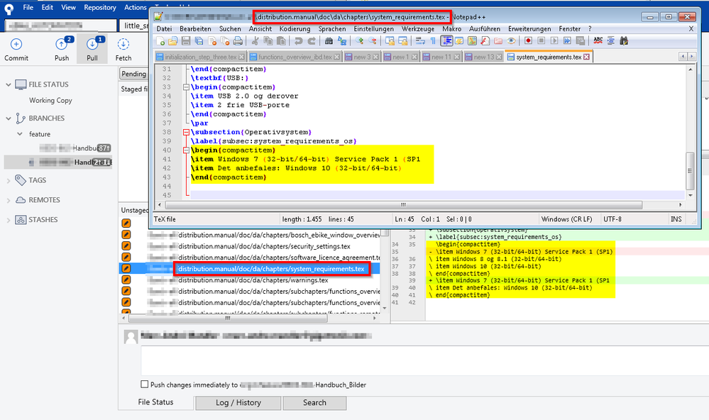

I overwrote a .tex file with another version of it. The version on disk is now exactly as i want it. Sourcetree is showing the file as altered, but not all alterations are shown, and some nonexistent alterations are shown. Additionally the line-numbering is off.
See attached Screenshot: (yellow highlighted regions)
I opened the file in Notepad++ to show the real content, and you can see in the background the Sourcetree diff, with wrong line numbering (observe that the real /begin->/end block is four lines from 40 to 43 and the Sourcetree diff is a weird /begin->/end/end block) and, very importantly: A line that does not exist anymore (Sourcetree line 36) is not marked as missing!
I tried commiting, the commit works with the real file, and also reverts fine, but the shown diff is always wrong. Altering stuff in N++ and saving resulted in a still wrong diff, that some times showed a +/- of lines that were unaltered and mostly showed the altered line (i experimented with the Windows 8 line ) as unaltered.
A diff using the diff tool from TortoiseGit was normal and correct.
Just to be clear: I doublechecked that N++ and Sourcetree are seeing the same file, by altering it in N++ and seeing the file change in Sourcetree - so this is not about looking at different files, this is some bug(?) in the ST-Diff (not the actual storing of files, just the showing of the differences)
Anybody know what causes this? It is very disconcerting to not be able to trust the diff.Sourcetree-Problem.png

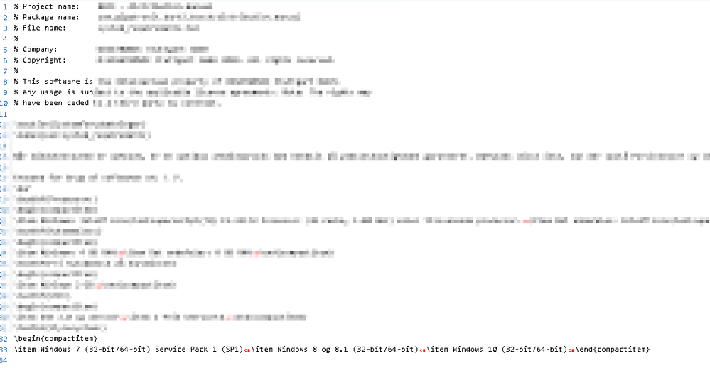

Screenshot from Bitbucket, of older version of the file, with "Windows 8" line as part (?) of Line 33 ??
bgannin
May 23, 2018
Hi Andre,
This is an excellent bug report. Please file these details in our public tracker, https://jira.atlassian.com/browse/SRCTREEWIN, and we'll take it from there.
Thanks,
Brian Ganninger
Product Manager, Sourcetree
Andre_Mandler
May 24, 2018
There seems to be an issue with CR as sole newline character, that (seemingly) won't get fixed: https://confluence.atlassian.com/sourcetreekb/diffs-do-not-render-correctly-due-to-an-old-style-mac-line-endings-265902596.html
