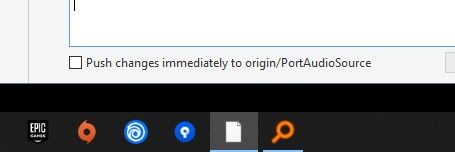

Since I upgraded to 3.3.6, when I launch SourceTree it places a new blank icon on the start bar instead of the Source Tree icon.

Having pinned one of these to start bar, if I launch from start bar (or by running exe directly), SourceTree starts up and a new blank white icon appears on my start bar. I can pin this to the start bar

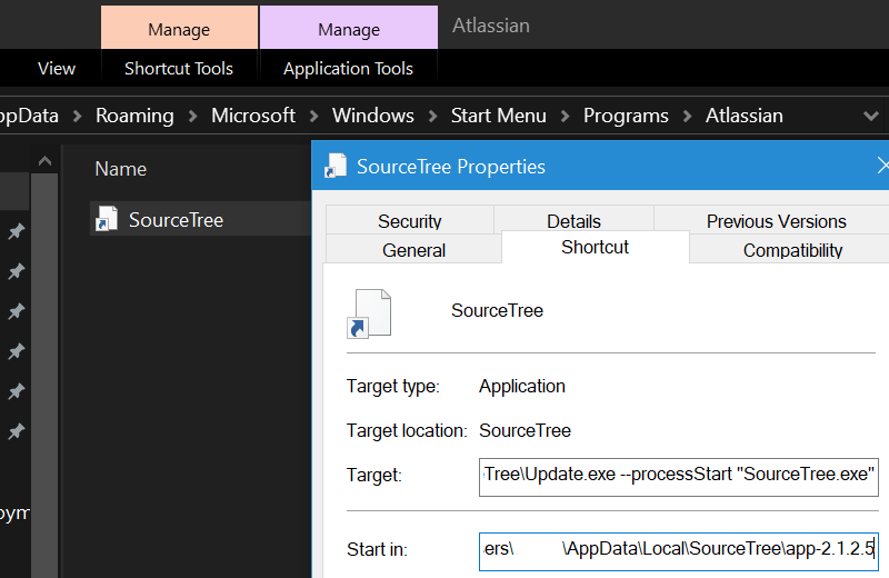

Can confirm. You need to go to the properties of the shortcut (C:\Users\{username}\AppData\Roaming\Microsoft\Windows\Start Menu\Programs\Atlassian) change the "Start in" location (remove\app-2.1.2.5 from the end) and click the Change Icon button to tell it to look in the right spot for the executable (C:\Users\{username}\AppData\Local\SourceTree). After that you should be able to pin the shortcut with the icon.
I did not have to touch anything in the User Pinned\Taskbar folder though.
Bad "Start in" location proof:
