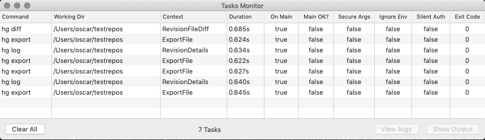

I tried to disable all the Sourcetree › Preferences › Mercurial - Extensions I could (shelve, hgsubversion, hgflow), and the timings improved:
Better, still, this seems weirdly slow to me.

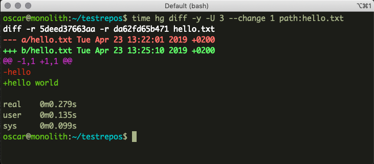

This is what 'diff' takes using Mercurial 4.9.1 from MacPorts:
What is going on?

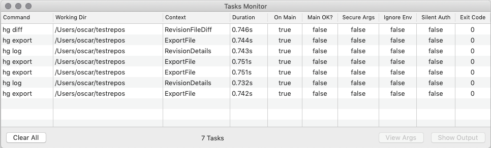

Found the Debug menu.
These are the commands being issued in the above sequence:
So 7 invocations of Python. These are all the arguments:
diff -y -U 3 --change 1 path:hello.txt
cat -y -r 1 path:hello.txt
log -y --template {node}␞{parents}␞{date|isodatesec}␞{branches}␞{author}␞{desc}␞{tags}␞{svnrev}␞{node|short}␞ -r 1
cat -y -r 0 path:hello.txt
Thinking out loud:
  • The 'export/log/export'-trio is executed twice, with exactly the same arguments?
  • What's the 'export/log/export' about anyway? Is it really necessary? Isn't all the info needed to refresh the view given by 'diff' alone?
