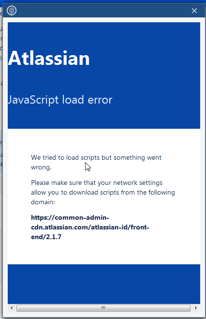

Hi,
 I had uninstalled source tree 1.8.3 and trying to install 1.9.6.2 but system says the most recent version of source tree is already installed on this computer, also tried to install latest version of source tree, but popup saying "JavaScript load error" shows on click button "use an existing account".
can you please help me resolve this issue?
Thanks

Regarding the error you mentioned when clicking the button "use an existing account", I guess you'll need to fix JavaScript in your Internet Explorer as Sourcetree relies on it for the authentication. You can find the instructions at https://support.microsoft.com/en-us/help/3135465/how-to-enable-javascript-in-windows

these all ways I have already tried and didn't get a solution and I am using chrome not IE.

the above-mentioned ways already had tried and didn't get a solution and the screenshot attached above.

Sourcetree uses IE for the authentication, regardless of which browser you normally use so we'll need you to confirm that the settings in Internet Explorer are correct so be can identify if this is causing the issue or not.
Make sure your IE is updated and follow the steps at How to enable Javascript on Windows to fix JavaScript in your Internet Explorer as Sourcetree relies on it for the authentication.
If after this it still fails, let us have a look at the logs.

made settings changes in IE still not working. I am using IE8, is that causing an issue?

Issue solved.
updated IE8 to IE11.
