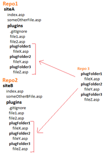

I'm trying to find out if it's possible to share the same repository between two projects with Git/SourceTree.
I have a two sites with their own repos, both have a plugins folder. Currently, any changes I apply to one plugin, i have to do the same to the plugin on the other site.
I've now created a 3rd repo just for my plugins (i.e. plugFolder1/2/3), I've not included file1.asp, file2.asp, .gitIgnore as they are unique to the site. This structure cannot be changed.
Is it possible to share my plugins repo and pull its content to siteA/B plugins folders. That way I can make changes to my plugins in their receptive site and commit the changes back to the plugins repo for the other sites to pull.
I've looked into submodule and subtree, when I try to add them via SourceTree, I don't understand how I'm able to pull the content from my plugins repo into my site plugins folder.
I have never used any complex stuff within GIT and I don't want to do it wrong. Thank you in advance.
Current setup
SiteA
 > plugins
    .gitIgnore
    file1.asp
    file2.asp
    plugFolder1
    plugFolder2
    plugFolder3
SiteB
 > plugins
    .gitIgnore
    file1.asp
    file2.asp
    plugFolder1
    plugFolder2
    plugFolder3
Expected setup

Thank you so much for your assistance, it's the most information I've been able to get in the last few weeks. It’s in line with I was attempting to do but I doesn’t seem to work because the destination folder already exists in sitesA/B.
When I create a submodule in siteA/B, I add the following
Soure path/URL: D:\webapps\testSites\sitePlugins
Local relative path: plugins
I get the following error
git -c diff.mnemonicprefix=false -c core.quotepath=false -c credential.helper=manager-st submodule add -f D:\webapps\testSites\sitePlugins plugins
'plugins' already exists in the index
As illustrated in my original message
Repo1
D:\webapps\testSites\siteA\
Repo2
D:\webapps\testSites\siteB\
The above repos each already have a folder called plugins and it contains files relevant to the site
index.asp
mappings.asp
PluginRepo
D:\webapps\testSites\sitePlugins\
Inside the sitePlugin repo I have;
plugFolder1
plugFolder2
I want to be able to pull the content from PluginRepo into
siteA\plugins
siteB\plugins
I hope you're able to advise me how to deal with this situation.

minnsey
September 11, 2017
Hi David,
Reading through your response I think the only aproach is to restructure your proects slightly.
Keep
SiteRepo1
SiteRepo2
With the following respective folders
D:\webapps\testSites\siteA\plugins
But split your site plugins repo into 2, one each for pluginfolder1 and plugin folder2, as follows:
PluginRepo1
D:\webapps\testSites\sitePlugins\pluginFolder1
PluginRepo2
D:\webapps\testSites\sitePlugins\pluginFolder2
Then you should be able to add each as submodules into the \plugins folder of each site.
Effectively running the following on each site repo
git submodule add -f D:\webapps\testSites\sitePlugins\pluginFolder1 plugins\pluginFolder1
