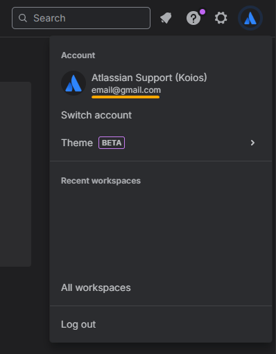

@zianliu hmm... 🤔
So, if you navigate to https://bitbucket.org/ and expand your profile on the right side of the screen, what's the email you've got stated there? This is your email connected with your Atlassian account, which should then be used as a username when adding credentials to Sourcetree.
@Tomislav Tobijas Thanks for your help. And By checking this info, I can confirm the email is the google email I use. I think this should be a bug that I found.
