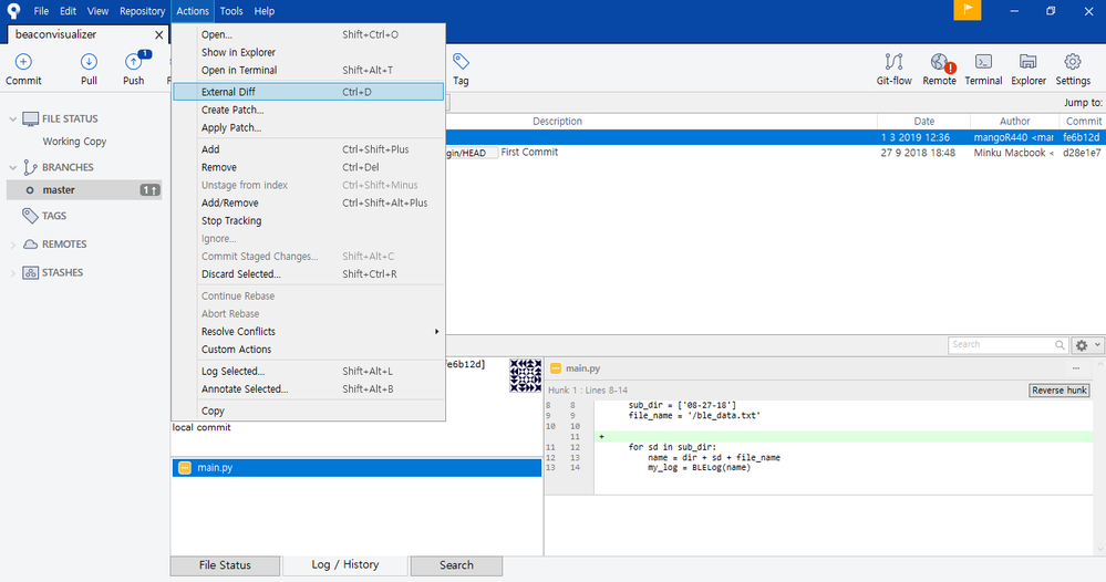

Hi, this is Minku.

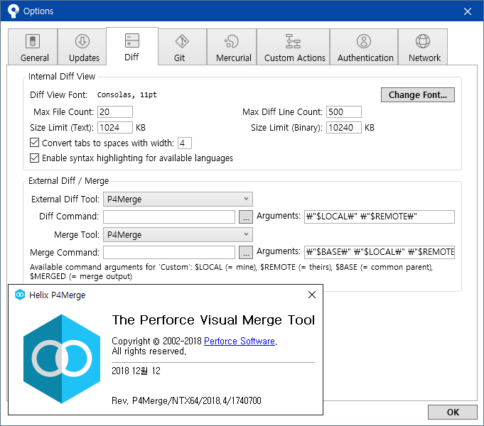

I have downloaded P4Merge and SourceTree 3.0.17.2659 on my 64-bit Windows 10 laptop.
diff.pngdiff config.pngThe W looking thing is a WON currency. It is shown like this because I'm using a Korean-based laptop.
https://superuser.com/questions/787664/why-are-backslashes-displayed-as-%E2%82%A9-korean-won-sign-w-strikethrough-in-not
However, after I click the "external diff", nothing happened.
How can I launch P4Merge and compare files?
-Thanks for the help, MInku

Hi
It is possible this is a bug, we have a fixed some in this area in the upcoming 3.1, but can you check the contents of your git config, it should look like
difftool.sourcetree.cmd='C:/Program Files/Perforce/p4merge.exe' "$LOCAL" "$REMOTE"
mergetool.sourcetree.cmd='C:/Program Files/Perforce/p4merge.exe' "$BASE" "$LOCAL" "$REMOTE" "$MERGED"
mergetool.sourcetree.trustexitcode=true
Also in the Tools/Options/Diff tab I would expect to see the  path to the P4 .exe

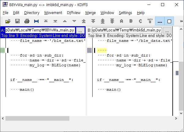

mangotamu
March 7, 2019
Hi, Michael
"Also if you try installing an alternative like kdiff3 and configuring that does it start working?"
I installed the KDiff3 64-bit. This works when I press Ctrl+D.
Here's what I found. My Scenario:
Set the Diff tool to KDiff3. Then execute Ctrl+D and we will see it is working.
The KDiff3 really pops up fast that it didn't took a second. I'm testing this with a laptop that has i3 processor and SSD, BTW.

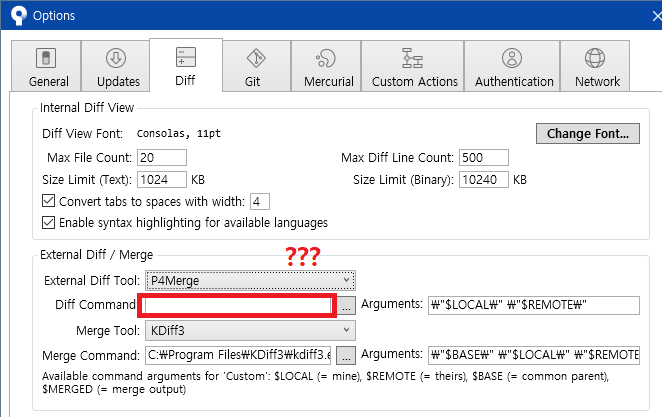

Now go back to settings and choose P4Merge.
Surprisingly, compared to the case when I choose KDiff3, if I choose P4Merge, it shows a blank on the Diff Command. Anyways, I pressed Okay.
NOW, when I press Ctrl+D, P4Merge pops up.
But it took like 3.5 seconds and I noticed the green progress bar. This bar doesn't always appear after pressing Ctrl+D.
So I thought everything was solved. However, after I turn off SourceTree and run it again, P4Merge doesn't show up when I press Ctrl+D.
In contrast, when I have a merge conflict, P4Merge does pop up when I try to solve the conflict with the external diff tool.
Can you guys try this as well and see if this is re-generatable on your side?

minnsey
March 11, 2019
Thanks for the additional details.
A couple of notes.
When you change diff/merge tool the path will initially be empty it gets set when you close the preferences, so that is OK.
Are you using Git or Mercurial? We are aware of some issues with Mercurial and external diff/merge tools which are fixed in the upcoming 3.1 release.

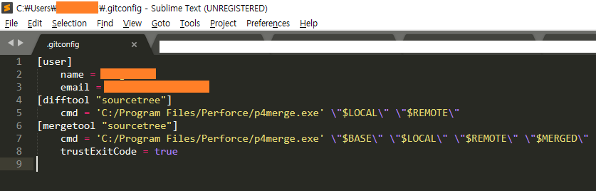

Mike Corsaro
March 4, 2019
Hello! Could you post a part of your ".git" config file for me? You can find it under "C:\Users\USERNAME_HERE\.git"
Please post the part under "[difftool "sourcetree"]"
Thanks!
mangotamu
March 4, 2019
Hi, Mike.
cmd = 'C:/Program Files/Perforce/p4merge.exe' \"$LOCAL\" \"$REMOTE\"
[mergetool "sourcetree"]
cmd = 'C:/Program Files/Perforce/p4merge.exe' \"$BASE\" \"$LOCAL\" \"$REMOTE\" \"$MERGED\"
trustExitCode = true
When I opened it, it was shown like the above picture.
But still, P4Merge doesn't show up when I choose "External Diff".
