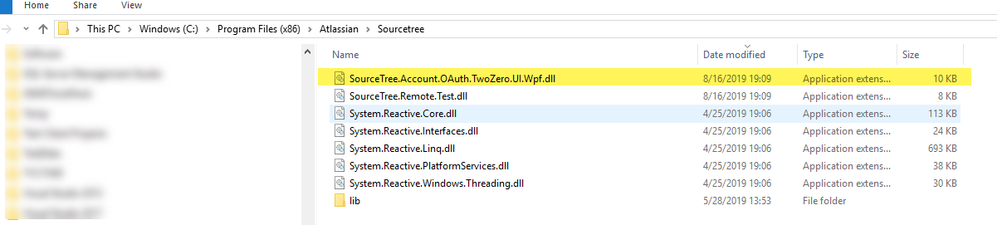

Ran into the same issue and the main clue was:
expected exactly 1 export of SourceTree.Accounts.IRemoteHostAuthenticationInteractionsManager`1[SourceTree.Api.Account.OAuth.TwoZero.IOAuthTwoZeroOAuthConfiguration] but found 2.
After uninstalling SourceTree there was still some leftover cruft  in the C:\Program Files (x86)\Atlassian\Sourcetree path:
Deleting the C:\Program Files (x86)\Atlassian\Sourcetree folder and then reinstalling SourceTree resolved the issue for me.
