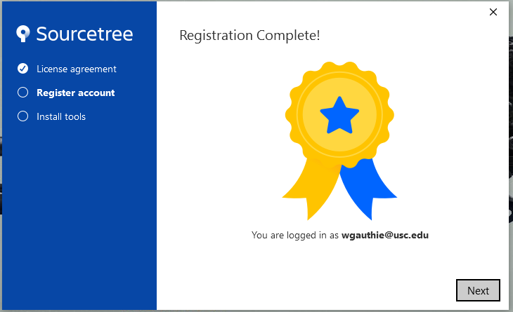

Will Gauthier
June 19, 2018
Hi Ana,
I have this same issue of the next button on the registration successful screen not taking me anywhere after logging in with my Atlassian account.sourcetreeRegistrationSuccessfulStuck.PNGI'm on Windows, and here is the entry from my SourceTree logs from the time I was trying to install:
ERROR [2018-06-19 17:34:50,118] [1] [SourceTree.Notifications.NotificationsManager] [PushFlagNotification] - Unable to push notification
System.IO.FileNotFoundException: Could not load file or assembly 'System.Xml.ReaderWriter, Version=4.1.1.0, Culture=neutral, PublicKeyToken=b03f5f7f11d50a3a' or one of its dependencies. The system cannot find the file specified.
File name: 'System.Xml.ReaderWriter, Version=4.1.1.0, Culture=neutral, PublicKeyToken=b03f5f7f11d50a3a' ---> System.IO.FileNotFoundException: Could not load file or assembly 'System.Xml.ReaderWriter, Version=4.0.10.0, Culture=neutral, PublicKeyToken=b03f5f7f11d50a3a' or one of its dependencies. The system cannot find the file specified.
File name: 'System.Xml.ReaderWriter, Version=4.0.10.0, Culture=neutral, PublicKeyToken=b03f5f7f11d50a3a'
WRN: Assembly binding logging is turned OFF.
To enable assembly bind failure logging, set the registry value [HKLM\Software\Microsoft\Fusion!EnableLog] (DWORD) to 1.
Note: There is some performance penalty associated with assembly bind failure logging.
To turn this feature off, remove the registry value [HKLM\Software\Microsoft\Fusion!EnableLog].
at NotificationsExtensions.BaseElement.GetContent()
at SourceTree.Notifications.NotificationsManager.PushNativeNotification(IFlagNotification notification)
at SourceTree.Notifications.NotificationsManager.PushFlagNotification(IFlagNotification notification)
