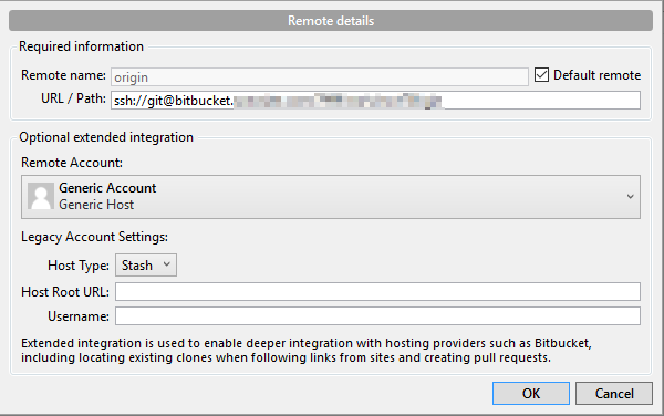

I have installed an evaluation version of Bitucket Server on a PC on my local network. I have then installed SourceTree on a different PC. After committing an update on a branch I want to perform a pull request. If I do this within SourceTree it tells me I must configure a remote before it will allow it.
Specifically, it wants the following information.
Required Information:
Remote name: ???
URL/Path: ???
Host Type:
Host Root URL:
Username:
What do I enter for all of this? The URL to the Bitbucket server is: 192.168.1.129:7990
The full URL to the repo is: 192.168.1.129:7990/scm/tp1/repo1.git
I have tried variations of this already and have not had success. Note that if I open a browser and go directly to the BitBucket and create a pull request there, that seems to work fine. Is it possible to do this from within SourceTree?

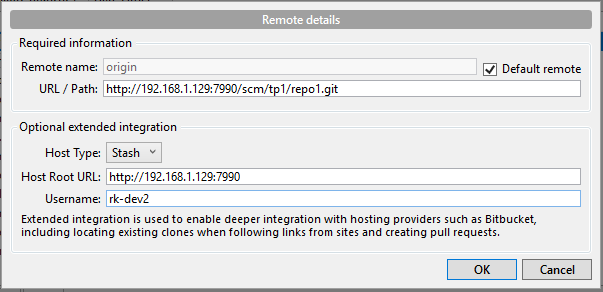

In Sourcetree, in the tab for your repository click on Settings in the upper right-hand corner. From here select the remote repository path (origin by default) and then select Edit. From here you can enter the Host Root URL (http://192.168.1.129:7990) and your username.
Yes, on Sourcetree Windows the host type is Stash for Bitbucket Server, which is the old name before Atlassian renamed it to Bitbucket Server.
This is what I entered:
Where "rk-dev2" is the user name on the PC trying to create the pull request from SourceTree.
Let me know if you see anything you think is incorrect.
