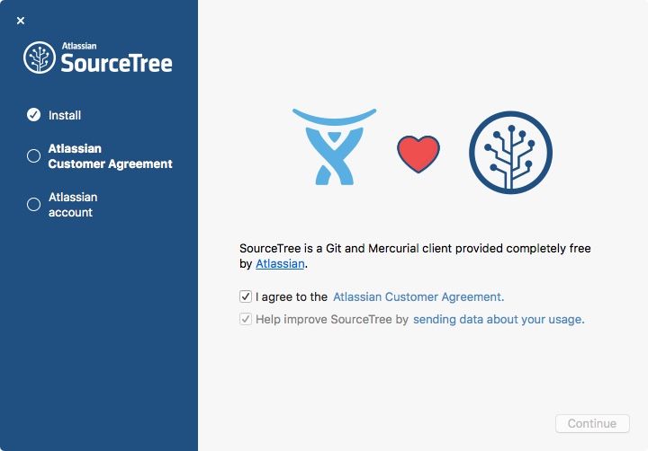

I had SourceTree working and running correctly, but after reboot it went into installation mode and on first page, that is called "Install" and does not enable "Continue" button after I agreed to the terms and conditions making application unusable. I tryed removing SourceTree folder from ~/Library/Application Support/, but didn't help. Tryed to install earlier versions, same story. OS X is 10.12.4.
Screenshot:

Hi Mark, can you try resetting the preferences and see if this error goes away? The instructions can be found at How to wipe SourceTree preferences. Once you do that, you can download SourceTree from our website and install it again.
If this doesn't work, can you provide any logs? On Mac, the SourceTree logs can be found by opening the Console application and searching for entries related to "SourceTree".

Thank you so much for your help! I found a solution. I'm on the latest Mac and deleted ~/Library/Preferences/com.torusknot.SourceTreeNotMAS.plist, nothing else helped . That solved the issue. Probably you need to update step 4 in a page you provided.
