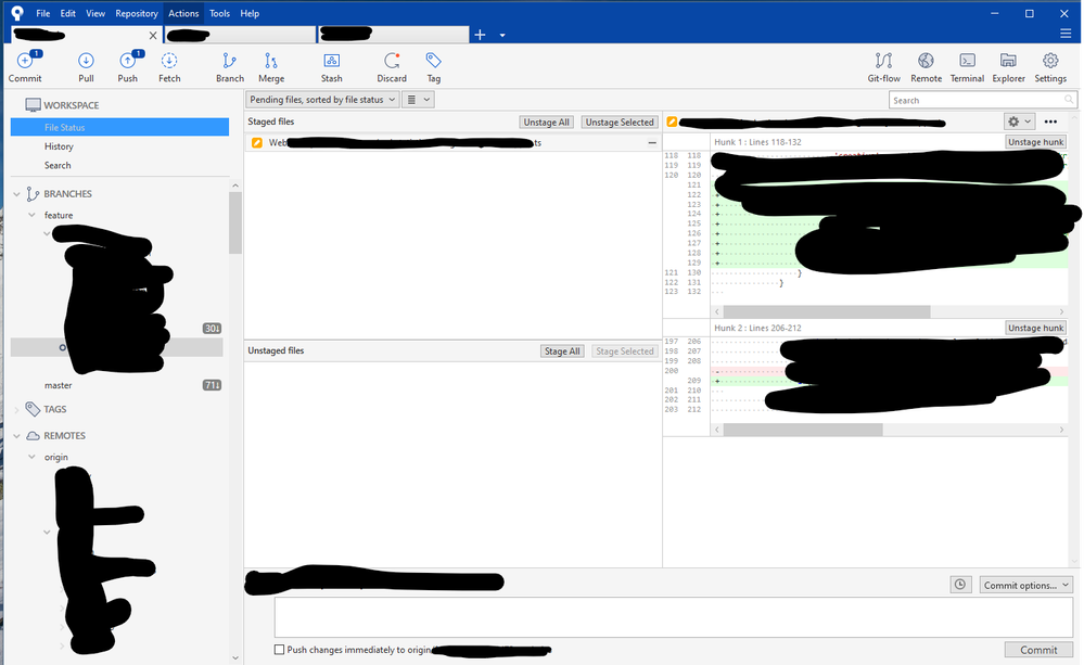

If I understand OP correctly I am experiencing the same thing now. It started immediately after updating to version 3.3.7.
What happens is the GUI doesn't "refresh" after doing something like staging changes or commiting. Only after restarting it will the GUI update.
Here's a screenshot that kinda illustrates the problem. Note it has the "1" bubble on the Push button, but Commit-button still has it's "1" bubble, even though there are no uncommited changes at this point, and I've not been sent away from the commit screen even though it has been commited.
What I've done to reach this point is:
  1. Hit Commit button in toolbar
  2. Write commit message, hit Stage All button
  3. Nothing is staged, nothing happens (seemingly)
  4. Restart the app
  5. File is now showing as staged
  6. Write commit message again as it was emptied
  7. Hit lower right commit button
  8. Nothing happens, except Push-button in toolbar now shows the little "1" bubble
Going back to history/list-of-commits-view it's still showing uncommited changes as if it was never commited. After restarting it again it was all showing correctly.
