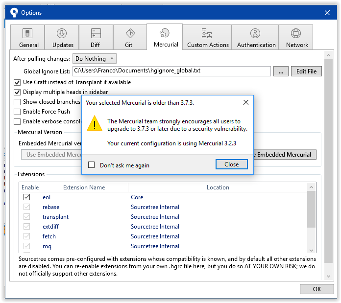

Hi Michael,
I have the Sourcetree v. 2.4.7.0 and in tools/options/mercurial tab I have Embedded Mercurial version 4.4.1, but I still get the error message.
Thanks and regards,
Franco
Hi
Do you still get the error dialog after closing and restarting Sourcetree? If so it sounds like a bug, If Sourcetree reports version 4.4.1 in that tab then it is using that version.
