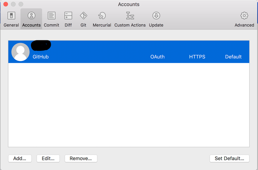

1. Have you added your GitHub account in Sourcetree?
2. If yes, what is the config? ssh vs https, basic auth vs OAuth?
Can you include some screenshots of the account setup in here?
Deleted user August 29, 2018
Here is the screenshot of the account settingsScreen Shot 2018-08-29 at 11.10.57.png
